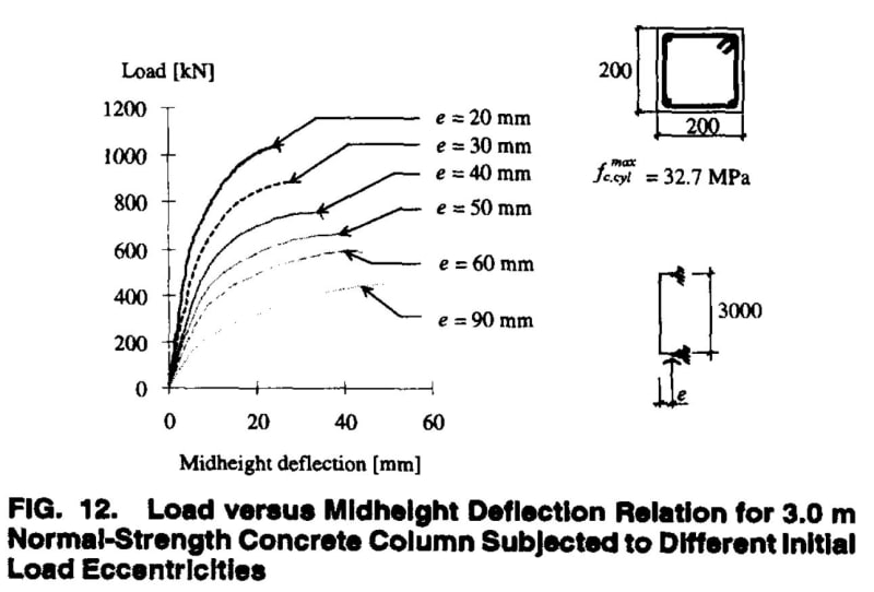

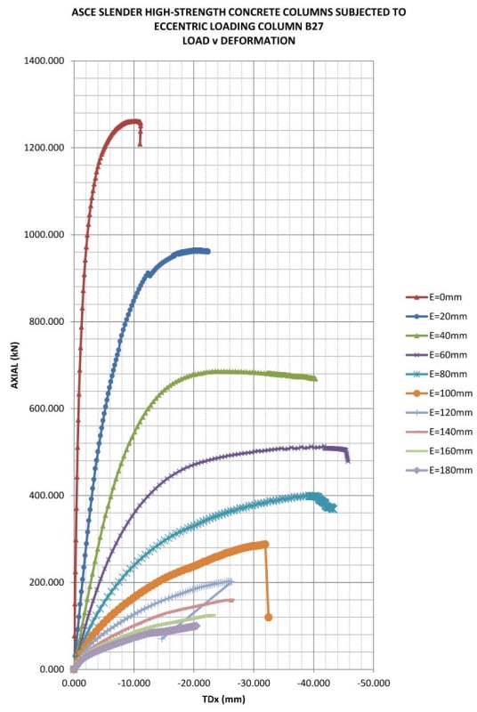

Enhineyero, no, that is not quite the situation. I have designs that require simplifications to design with normal procedures outlined in our code. These are cases where I would like to look closer at the design to gain a more complete understanding. Both the CSA code and ACI codes reference second order analysis, but are a tad light on describing the how part. We would only be looking for parameters related to the appropriate material models, and general model parameters. The final design would be per our code. I do appreciate your point of view. We had a review engineer for a project recently that shared the same thoughts.
We did calibrate one model to an actual test.
ASCE report:
Our model results:
The accuracy of our model was not correct at eccentricities > 60mm due to a boundary condition error, but it is quite reasonable otherwise. We will correct the boundary condition when time permits.
We have been using Diana FEA Link. They have been helping us along the way. There are quite a few other options out there. It is not very friendly cost wise, but none of them are. We only license it when we have problems that warrant such studies. We have a few details for one client that have always annoyed me and I want to have a better understanding. As I have been working on problems I have been thinking how to convince others of the analysis methodology. This has been a very helpful discussion to get a sense of what other engineers might think.
