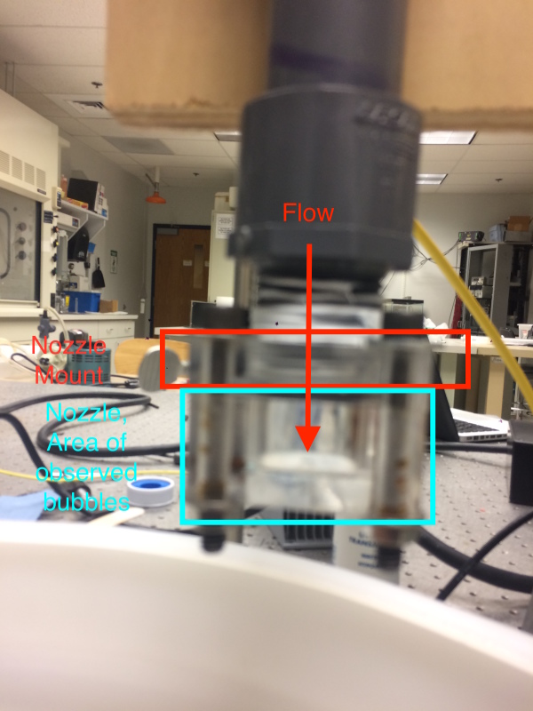

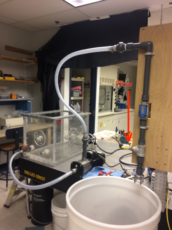

I am getting bubbles into my pipe system and wanted to know how they are forming and what I can do to remediate.
The flow begins at the a reservoir holding water that is open to the atmosphere. Water flows from the bottom via a gated valve and into a centrifugal pump. The flow is directed up and then down. The flow passes turbine flow meter, pressure gauge, and exits from an acrylic nozzle. The plumbing consist of 3/4" ID plastic tubing, and 1" ID PVC. The nozzle has a 1/5" square exit. The nozzle attaches by a mount. The mount screws onto a threaded PVC adapter and then nozzle is essentially clamped on.
At 8 liters per minute(lpm), I am observing small bubbles around the PVC adapter and acrylic nozzle connection. Then as I increase the flow rate up to approximately 9 lpm a large bubble (approximately 1") forms.
My initial guess is that I have air leak in the nozzle mount and nozzle area. I placed an o-ring in between the nozzle and the nozzle mount but the issue still persist.

Nice pictures, but I still can't tell where the nozzle, o-ring, nozzle mount, meter and PVC adapter are. A simple sketch with a couple of notes and arrows would be just fine.
Why do you need such a tall upwards pipe run and the drop back down into the bucket?
How is flow going into the bucket controlled?

Pictures are good, but the top picture is very blurred. I'm taking a guess that the top picture is a close up of the end nozzle?
The fact you're able to see the bubbles implies it is in the see through plastic section at the high point where it joins the plastic section to the black (acrylic?) piping??

It might sound a bit odd, but try lengthening the tubes and put the pump on the floor. Won't make any difference to the differential head as the head will balance out.
Or put some blocks under the tank and raise the tank compared to the pump
The system starts with a load of air above the tank.
Put a tee and a valve in place of the top elbow so you can bleed the air out of the hump for a few seconds after the pump starts.

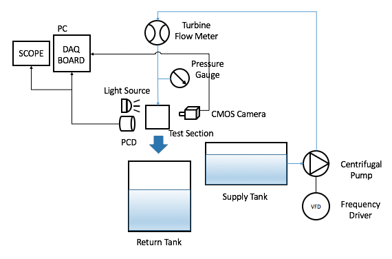

I have included a diagram of the system (the flow is designated with the blue line)(please ignore the other items).
BigInch: The flowmeter required a specific length in/out of the meter. Although, I can rotate that pipe 90 degrees so everything is lower. I am suspicious of trap air at the top of the pipe and would hope this would solve the problem. The flow is controlled with a variable frequency driver on the pump.
LittleInch: Yes, the inspection point that I am referring to is the acrylic section of my nozzle setup. The nozzle is acrylic and it is connected to schedule 80 PVC (grey) adapter (NPT). The pipe is 1 inch and at 8-9 lpm then the velocity 0.263-296 m/s inside the pipe. Water is at room temperature.

As noted in some of the other posts, basically once you get air inside, your velocity is insufficient to blow the air out of your nozzle.
Hence you either need to include a vent at the high point or have all of your tubing gently sloping upwards to the tank.
Or run it at a velocity of > 1m/sec at which point the system will flush all the air out.
Running a turbine meter with air around will give you some false readings.
If you replace the acrylic elbow with a tee and then put a valve on top this will allow you to vent out the water when under flowing conditions.

What exactly are you trying to do with this setup? If the purpose of the setup was known, it would make it easier to address the problems that you are having.
Why do you have a return tank, instead of returning to the supply tank?
The purpose of this setup is to drive flow into a nozzle/orifice to cause cavitation. I specifically wanted to keep the supply and return tank separate to minimized the bubbles entering the line.
At the moment, when I run the flow circuit, I can already see large bubbles entering the orifice via a "window" . These bubbles are persistent (and annoying). As I drive the flow relatively higher (2gpm max) they are there. I am convinced I have an air pocket inside my line somewhere. As I drive the flow up, small pockets break off and that is what I am seeing. I can run the set up for a while and the bubbles are still there which leads me to believe I probably have a leak. Also when I turn off the setup the siphon effect definitely introduce more air into the line.
At the end of the day I just want flow controlled cavitation. The simpler the better! Any suggestions would be much appreciated.

Re-reading this you don't appear to have enough velocity / flow rate in the tubing to drive out the air which is present, but the air bubble there lets a small amount go every now and then as the water flows past it.
Therefore you either:
1) Need to temporarily increase the flow rate, possibly via a tee before your nozzle to clear all the air out
2) slope all the tubing in one direction and then add a tee with a vent valve to remove the air.
3) Add a non return valve on the discharge of your pump to prevent back flow
Note that due to the vertical piece of pipe, you might get air in the vertical tube when you stop as it drips or flow out under gravity. I'm not sure you will ever be able to fully get that vertical leg air free unless you're flowing at more than 1m/sec.

I may be wrong, but it seems to me that the meter and nozzle do not need to be vertical.
A long radius elbow or hose downstream the nozzle or discharging into the bottom of another tank (or same tank with some internal baffles) could solve the problems associated to the inverted P-trap.

I agree with littleinch, run your setup horizontal.
Ted
I ran the system horizontal and it worked like a charm. Thank you for all the suggestions!
