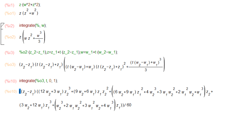

Hi Everyone,
I am trying to evaluate the bending capacity of an unequal length angle (L 127x89x9.5.
The CSA design equation requires you to calculate the symmetry parameter of the section and that involves the evaluation of an area integral. Please see the attached screenshot.
Does anyone know of a solved example or reference for the evaluation of this variable?
Thank you
 https://files.engineering.com/getfile.aspx?folder=50654d26-5db0-47e1-ac42-abb73ee045ff&file=Capture.PNG
to do the actual integral convert the problem to a sum of line integrals for each segment defining the perimeter of the angle.
Green's Theorem for line integrals
you'll need to find functions for P and Q such that the difference of the partial derivates = z(w^2+z^2)
z and w can the be written in parametric form for each edge vertices as, each (z,w) pair is a transformation of the (x,y) coordinates to the principal axis angle:
w(t) = w1+t(w2-w1)
z(t) = z1+t(z2-z1)
and then back substituted into P and Q so the integral is from 0 to 1 dt instead of dz or dw.

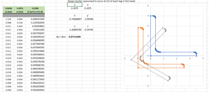

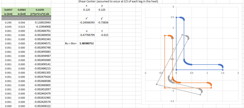

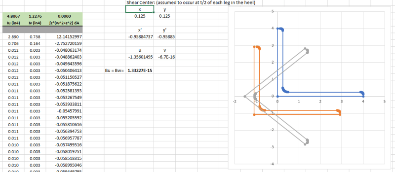

Sheet to compute Beta,w: Link
L8x4:
L4x3 1/2:
L2 1/2 x 1 1/2: (This one is actually sensitive to the thickness)
Equal Leg: (Numerical precision -- 1.33 E -15 is pretty much 0)
Formula for Each linear edge of the angle defined by start point (w1,z1) and end point (w2,z2):
For Green's Theorem assume P=0, so need to integrate the function with respect to w. Then perform the parametric substitutions and change of variable to dt.
The sheet models the fillets with several straight line segments.
