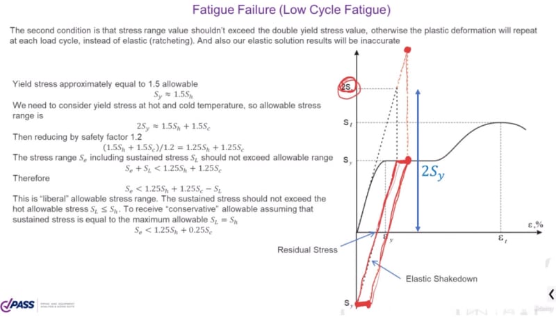

I was reading a thread about local plastic deformation and strain hardening effects and there were a couple of comments that I found to be confusing. Below is the link to the thread along with the two comments in question. I provide input below:

The first part about plastic deformation doesn't mean failure is imminent because the UTS hasn't been reached. I don't understand how the stress is redistributed. It's been a while since i studied materials (chemical engineer major) but i imagine this is because the change in the shape and volume of the pipe shifts forces at different points?

In this second comment i'm having a hard time understanding how the strain hardening effects on the pipe can make the pipe tolerate a stress above it's yield point even though it has yielded.
Lastly, why doesn't a self limiting stress create a failure mode?

Say there is a discontinuity in the pipe such as a hole for a unreinforced branch connection where the branch pipe cannot take any load. The load that is normally taken by the metal where the hole is can be calculated to be the width (diameter of the hole) times the thickness of the pipe times the global membrane stress in the pipe before the hole at that location. This membrane stress will be due to both longitudinal and circuferential pressure stress and other longitudinal sress due to such things as bending due to weight of pipe between supports. This load will now need to flow around the hole and it will do so around the perimeter of the hole. This is basically what is called a stress concentration factor where the actual stress increases above the global membrane stress that is across the entire pipe crossection at that location. Say that the original global stress in the pipe is just at the yeild point. Therefore the concentrated stress with the load flowing around the hole will cause the metal to be above the yeild stress and will cause the pipe around the hole to go from elastic stess to the plastic stress region as it flows around the hole. For a metal the stress strain curve is basically flat although there is a mild slope upward as the strain increases so that the maximum load that can be transfered through a metal once it reaches the plastic region is basically the value of the plastic stress times the area that it acts on no matter how much the material strains (say it deforms by elongating in tension for a tensile pressure stress). In this case the width of the plastic region around the hole will increase until there is enough crossectional area times the plastic stress value to balance original load plus the extra load flowing around the hole. So the higher the additional load flowing around the hole the wider the plasic region around the hole necessary to balance the load. So the load is redistributed around the hole by plastic deformation/strain of the metal around the hole. In such case the pipe will not fail unless the load is so high that the width of the plastic region at the hole grows to a value that basically extends across the entire cross section. However the width of the area in plastic strain typically does not extend that far beyond the hole since the original global membrane stress in much lower than the yield by design so that not much load has to flow around the hole due to the removed metal of the hole. These stresses around such discontinuities are grouped with secondary stresses and higher allowables stresses are allowed because of the fact that the loads are redistributed and are therfore self limiting rather than leading to gross failure of the member (such as the case for primary stresses that are not self limitin)

For Yt/St I meant Yield Strength/Tensile Strength. sorry for using the wrong variables.
I explained it here Lecture 15
I'm the PASS/START-PROF Pipe Stress Analysis Software Developer

Here is the way I understand strain hardening in a pipe, once the pipe reaches yield or slightly above yield say by over pressurisation and then the pressure is removed, this leaves a residual compressive stress on the inner face of the pipe. Now once the pipe is pressurised again there is a residual compressive stress to counter act against the tensile hoop stress in the pipe which is generated by the internal pressure. Hence pipes that have been subjected to this process can usually handle higher pressures than it normally would experience. My experience of this was autofrettage in pressure vessels.
desert fox what you describe is elastic shakedown which is the exact thing shown in the diagram that Alex M posted just above. Yes this is due to strain hardening phenomenon and stress reversal on load removal and then the reapplication of the load where then the stress will then be within the elastic range on subsequent cycles as you described, as long as the effective stress does not exceed approximately twice the yield stress per the diagram Alex M posted. This is the basis for ASME 31.3 allowable stress values for thermal self limiting stress of 2Sy approx.

Another way of saying or thinking about some of what’s been said above, is that the non-yielding mat’l. which surrounds a highly stressed region (yielding or plastic region) tends to constrain or confine the plastic region from growing, by absorbing some of the overstress as it too starts to approach the yield stress. The strain involved in the plastic (yielding process) can’t happen or grow, unless the surrounding mat’l. is further strained (causing growing stress level in that surrounding mat’l.) to allow this expansion. At some point equilibrium and compatibility are generally reached, and the plastic region growth stops. The important engineering design consideration is that some small amount of yielding is generally o.k., but it must be constrained, so it can’t grow unabated, or you can have a fairly quick failure. The definition of failure can be the start of significant yielding, some serviceability criteria, and finally ultimate failure/rupture or some such.
The stress/strain curve that Alex Matveeff shows above is a fairly idealized curve for some steels. Not always shown to exact/full scale along both axes. The horiz. portion (plateau) of the curve is the plastic range, where strain can grow without much increase in stress (the yield strength) unless inhibited/controlled in some way. Then, the further up-sloped portion of the curve is the strain hardening portion of the curve and stress will grow slightly with increased strain due to the strain hardening. And, many steels do not really have a horiz./plastic plateau. Rather, their yield strength is set at a .2% strain offset, and they only have strain hardening shape/slope to their curve right of this point.
