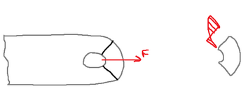

Hi, I am a mechanical engineering student and I wanted to ask some questions about design of mechanical parts so that they don't break, because I tried putting together all I learned so far and I noticed I have some gaps that apparently they didn't cover in my uni courses.
I think I already have a good grasp on how to design parts (made out of a ductile material such as steel) so that they do not yield due to a static load. The process is theoretically simple, you just have to make sure that for each point of the part you are considering, the Von Mises stress doesn't get bigger than the material yield strength. The part could be complex and the stresses inside could be difficult to determine, but in the end it all reduces to checking the VM equivalent stress.
My doubts are specifically about the breaking condition of a part, because so far they only taught me to design parts so that they don't yield. At university we only saw simple cases of breaking due to uniaxial tension and the net stress simply had to be less than the UTS of the material. In practice it is not always possible to prevent local yielding (as in small fillets, or where there are contact stresses) so usually you calculate the average stress and compare that to the UTS of the part in simple cases.
My understanding so far is that when a part is designed against breaking, you can no longer use a local failure criterion like Von Mises because stress redistribution happens and elastic stresses become kind of meaningless (or are there local failure criterions that work for this purpose?) so it is easier to use a non local criterion such as choosing a surface where you think the part will break and calculating the mean stresses there.
I chose some examples relative to bolted joints to better expose my doubts, not because my doubts are relative to bolted joints specifically, but because it is where I most often saw these kinds of problems appear.
1) If we consider a bolt placed near an edge, to prevent tear out we check the mean stresses on the surfaces on the drawing:

For surface 1 and 2 it is easy to determine if the part will break because the stresses will be only tension (1) or only shear (2). When it comes to surface 3 however it becomes more difficult to understand if the part will break, because after I find the shear and normal stresses on the surface, how do I understand if their current combination will result in breaking of the part? Again, I never heard of breaking criteria for ductile materials, only yield criteria, so I have no idea if the part will break along that surface or not.

3) When I have the scenario shown in the drawing below, how can I determine how much of the force will be acting as shear and how much will be acting as normal stress?
To verify that this kind of failure doesn't happen, I can just make sure that neither of the mean stresses on the two surfaces is bigger than the ultimate tensile/shear stress of the material. The difficulty is understanding how the load divides itself here. To add to this I also don't remember having ever seen the ultimate shear stress of a metal being tabulated somewhere, and I am quite sure it cannot be found from the UTS by using a yield criterion because that would indeed be for yielding stresses only.

In the sketch you show, experience with common metals shows that the 45 deg line is the critical design feature ... or better, there are methods that combine several ligament lengths (rather than use just the 45deg or the 90deg length). This is because on the 45 deg line the shear is producing tension stresses. And then of course there is bearing to consider.
Here the breaking surface transformed into a straight surface (tension stresses) during yielding. This would explain why we didn't cover breaking with multiaxial stress states.

Yes my bad, I didn't specify that I am interested specifically on breaking meant as separation of the part in two or more due to the stresses present inside the part itself due to a static load (no creep, fatigue, wear or corrosion). I was not referring to other conditions like excessive deformations. I think I may have misused the word "break" because I didn't know what word to use to indicate the above, and I didn't want to use the word "fracture" because I associated that with fracture mechanics and in my knowledge that theory is applied only when there is a crack already and you study its propagation.

Your sketch shows a hole with a bearing failure ... holes can elongate (thought typically not as much as your sketch !) without failing the part (ie without breaking the part into two).
Things break because the stress in the part exceeds ftu (and other modes too). A local failure (like hole bearing) is sustained because ...
1) the net section stress is less than ftu (a bearing failure shows the stress higher than fty), and
2) the local stress is not so high as to cause dynamic crack growth (ie the material is ductile and has a a high toughness).

Yes I was asking about static failures specifically. As for fatigue, luckily we had a teacher that is a researcher in that field, so we learned that part well enough (or at least the basics). Still, thank you for the sources about fatigue, mfgengear, I am sure they will be useful for a review of the topic, it never hurts!
