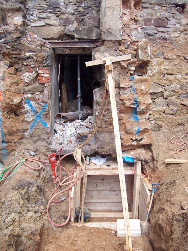

Here is another photo of a wood shelf that was installed to protect the worker in the pit from falling stones. Zoom in to see it more clearly. It isn't pretty but it is served the purpose. Additional blocking could have been placed on the shelf if the remaining stones were still loose,
PEinc,
Thank you so much for the extra photos and wisdom. This helps considerably. Looking at this and your presentation, I'm wondering what type of wood you are using. Would standard untreated pine suffice or do I need something else as a minimum? Also, since I won't have access to the exterior after the pour, the exterior width boards would be left in to rot. Is that okay, or is it preferred to remove them prior to the pour? Since, my dig heights are relatively shallow (14 to 18"), I don't think I'll run into needing the exterior boards for soil shoring. Thanks again, as all your responses have given me tons of insight into this project.
The horizontal shoring boards are dressed 2x10's, softwood (Pine, Hem-Fir, or Doug Fir-Larch)), untreated. On some (very few) jobs, the project engineer may want CCA-treated wood if worrying about termites (usually for museums and other historic buildings). The vertical corner cleat boards are 2x4's. These boards work for most underpinning piers where the maximum side length may be about 6' or less (and depending on the competency of the soil). Infrequently, pits are bigger and full-cut, 2x10's or 3x10's may be used.
The only boards that get removed are those boards between adjacent underpinning piers and those on the front of underpinning that will eventually be exposed. The other boards cannot be removed.
Usually underpinning pit excavations are shored with lumber, especially when the pits are deeper than about 4 feet (OSHA requirements, confined space, etc.). If you are digging shallow pits, and if the sides stand satisfactorily, and if the excavated pits are not too wide, and if you will be placing the concrete the same day; you may be able to get away without shoring the 2 sides and back. You should form the front of the shallow pier with braced plywood to have a neat, plumb concrete face.
I see. So if you leave the earth side boards and cleats, do you just attach another face cleat to the previously embedded cleat when you come to the final piers between cured poured piers? Thanks.
When you dig a pit between 2 completed underpinning piers, you strip the side, horizontal, shoring boards from the adjacent, completed piers and you install the rear horizontal boards. The ends of these boards can be tucked behind the corners of the adjacent piers or you can install 2 new, vertical, 2x4 cleats to the rear cleats of the adjacent piers if their cleats are still there. The same can be done for the front, horizontal boards once you excavate below the approach pit.
