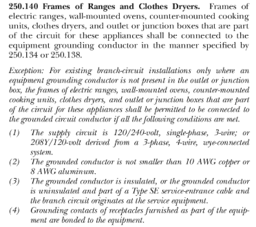

Under the Canadian Code, for systems below 150 volts to ground, a four wire circuit must have five wires;
Three phase wires, a neutral wire and an equipment grounding wire or other conductor.
I understand that under the NEC at one time, residential electric ranges shared a single conductor for both neutral and ground.
I was under the impression that that had changed. What is the current regulation?

Thanks wroggent;
Does this mean that new installations must have a dedicated equipment grounding conductor in addition to the grounded circuit conductor, but legacy installations without a separate equipment grounding conductor are grandfathered?

waross, yes, however jurisdictions adopting the code have the ability to exclude the exception or modify it. I don't know if that's common or not.
