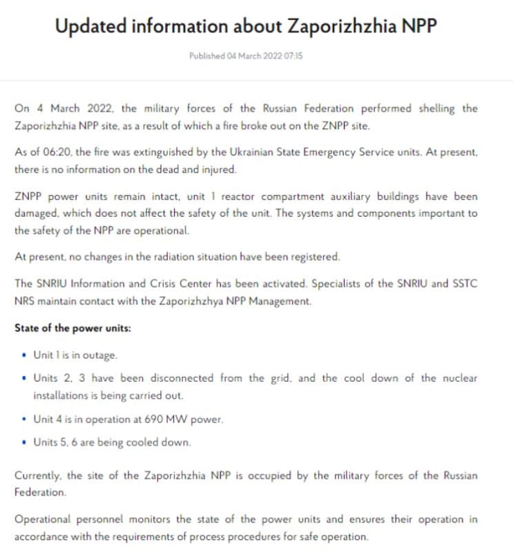

5 cores were shut down on invasion and 1 was scrammed when the plant came under attacked.

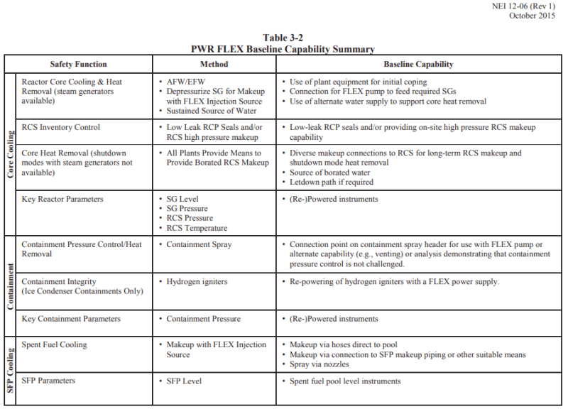

I'm thinking along the lines of choppering in supplemental equipment like this:
This is an excerpt from the NRC FLEX Implementation Guide (

Video purportedly from inside one of the control rooms during the attack:
“Stop firing at the nuclear facility,” a voice says. “Immediately stop firing. You are endangering the safety of the entire world. The operation of a crucial part of Zaporizhzhia’s plant could be damaged. We will not be able to restore it.”

Alistair, these units are designed to be choppered in if necessary. After Fukushima, dedicated FLEX staging areas were built all around the US. I believe many were located strategically, equidistant to as many plants as possible. One of the projects I worked on was set up so all the equipment was containerized and designed to be “plug and play” when needed in an emergency situation. The downside is that the plants had to have those plug and play connections installed on their end for this to work. I doubt this is the case in Ukraine.

Even if Russia is in control of the plant, the war fighting is still ongoing and the danger to the plant is ongoing. The west could give the FLEX units to Russia for all I care, just get something in place for when the grid inevitably goes down.
