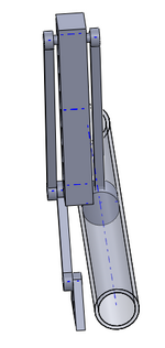

Andrey29R, your mechanism diagram and explanation of operation still leaves me with a misunderstanding: how does the working piston and its connecting rod travel the long length of the combustion chamber all while maintaining a closed cylinder? Am I totally missing the design?
I have scaled the link proportions from your schematic.
1. Piston at the start of stroke - the connecting rod from piston to the crank link must pass thru the cylinder wall.
2. Mid-stroke the connecting rod will strike the piston skirt.
3. Crossing past mid-stroke the connecting rod will slice thru the piston.
4. At full expansion the connecting has flipped its working angle, cut thru the piston and cylinder wall. The crank links and slider have crossed over two stall points that could cause rotation reversals to occur unless a counterweight is properly designed. I chose to show the slider as just a guided rod - having the second 'piston doesn't really provide any bearing function.
I have pondered your mechanism this past weekend while up on ladders painting my house and for all the hours spent under eaves and backrolling paint, I still don't understand how you will seal a combustion chamber and have the mechanism in your schematic.
Please clarify this mechanism for me.

View attachment 903View attachment 904
View attachment 905View attachment 906
View attachment 907View attachment 908
Thank you for your comment and the attached diagrams!
I imagine it roughly as it is shown in the attached diagram. The extension element is attached to the piston inside the combustion chamber.
I think that this is a solvable problem one way or another.

OK, now I understand. Your moving schematics are not showing the long fixed extension arm from the piston. This long arm is going to impose significant moment on the piston, increasing friction and the potential for jamming. Certainly, the piston length can be increased to work but then its mass increases. I will like to see your prototype.
OK, I understand, your schematic is not showing the long fixed extension arm from the piston. This long arm is going to impose significant moment on the piston, increasing friction and the potential for jamming. Certainly, the piston length can be increased to work but then its mass increases. I will like to see your prototype.
