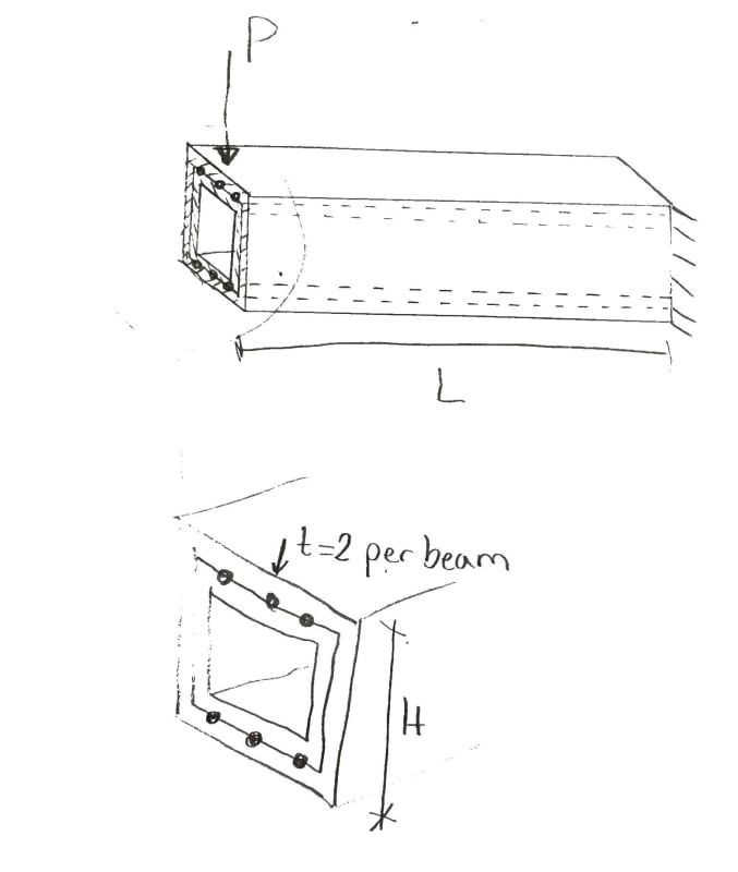

I have a friend who asked me how I would go about analyzing the max value of P in the situation shown in the picture.
Two steel profiles are fitted into each other. Both are fixed to the support, but the beams are only connected to each other with spot welds at the beams' ends.
To me it looks as if the stresses from the outer profile must be transferred to the inner profile through the spot welds, which could reduce the load that the profiles can withstand.
[ul]
[li]What theories are of importance to analyzing this situation? (e.g. Grashoff?)[/li]
[li]Will the spot welds be a limiting factor to the size of P?[/li]
[li]How would you go about analyzing this scenario, if both the displacements and P_yield is of importance?[/li]
[li]How do you calculate the max value of P?[/li]
[/ul]
The scenario left me curious, as I have barely any idea how to answer his question.

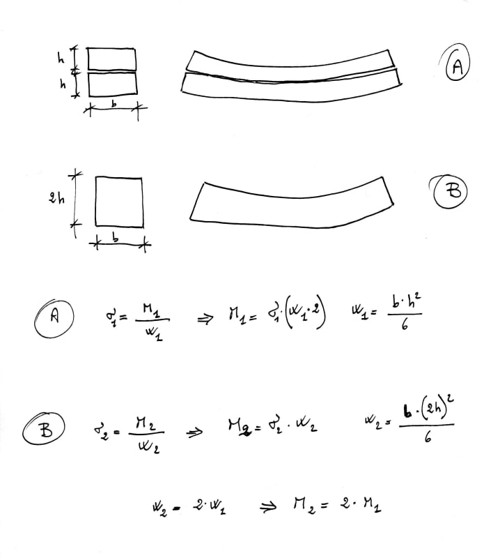

easier for me to show the explaining formulas (case A - tubes fitted inside each other without welds or overlapped without welds is same ; case B - same as previously said but welded all along)

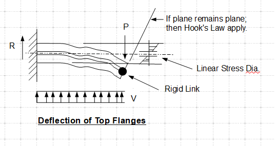

This beam is a composite beam, if the spot welds are capable of resisting the shear flow, VQ/I, at the interface. For this case, V = P. So the key here is the strength of the spot welds. The rest design checks can then be performed on the composite/built-up section, provided it is a cantilever as shown.
To me, it seems kind of iffy to count on spot welds at the end of the beam to resist the entire shear flow.

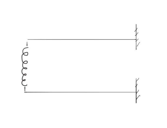

If you assume that the inner tube is free to slip in relation to the outer tube, ie no frictional resistance, then you could model it as two cantilevered beams coupled at the end with a spring representing the spot welds.
@robyengIT that is what I am starting to understand. It is basically equivalent to two beams in parallel, right? Where k is the bending stifness.

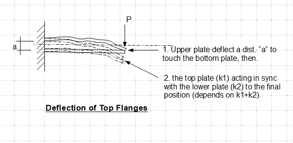

Yes, if the welds are strong enough to resist the shear flow, so the tubes are bind together on both ends to form a built-up shape. For such case, regardless of gap in between, the stresses are proportional as in an integral section. If the welds do not hold, When the gap is closed by the deflection of the outer tube, it becomes a spring between the tubes condition as pointed out by Celt83.

@r13 Your last sentence confuses me slightly. If the welds do not hold, why would I have a spring representing their stiffness? If the spot welds do not hold, it is equivalent to them not even being there, right?

Hope this diagram makes sense. Note, shear flow approaches maximum at the neutral axis, at which Q is maximum.
nikoD,
Hope this sketch explains.
Correction, in step 2, the final deflection depends on the springs k1 and k2 in series. The numerical addition of k1 and k2 is incorrect.
