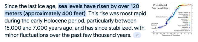

Actual numbers are that sea level rise is 3mm/y, or 1 ft per century. The tidal range (low low water to high high tide) where you live might be as little as 2 ft, or as much as 20 ft. Since the last Ice Age sea levels have risen by dozens of feet. As such worry warting about a foot in a hundred years seems a bit daft.
