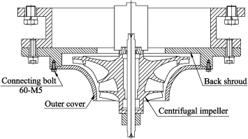

Turbocharger tension rod. How does it work ?
Aug 30, 2012
204
Anyone got a cross section sketch of this or a procedure ?
In your picture it appears they are using a hydraulic jack to push the turbine on to the shaft. It is an adaptation of the SKF OK coupling system.
A similar process is used to fit propellers on ships.
It's also possible they are tensioning the nut that retains the turbine.
That is also a SKF product.
