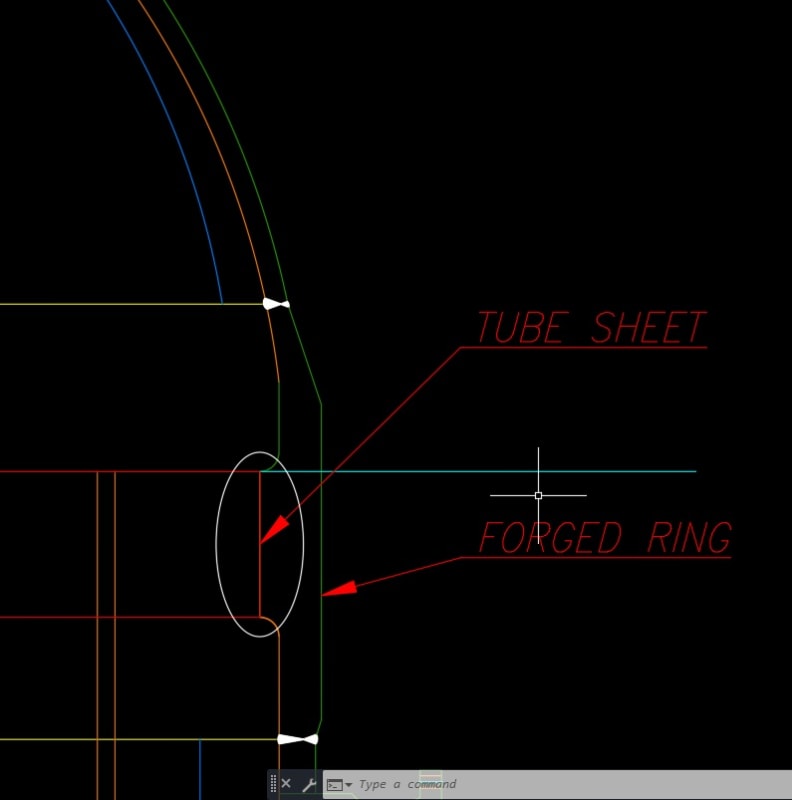

we have methanol reactor. between head and shell is tube sheet with 380 mm thk.
shell thk. is 95 mm and head type is hemispherical with 55 mm thk.
we use ring joint to attach shell head and tube sheet. please give me your advise which kind of weld joint could be use for ring joint to tube sheet.
material of head : sa-387 f22 cl.2 with 4 mm s.s tp 347 weld overlay cladding
material of tube sheet is sa-387 f22 cl.2 with 6mm Inconel weld overlay

Naser KHAN, can't make heads nor tails out of your graphic. Perhaps you could persuade some one to make a legible hand sketch...

In this case it is not usual to perform PWHT, but your drawing is not very clear. EDSTAINLESS gave you some justifications, but the welding filler metal is also important.
luis
Your highly unconventional and heavy welded joint as well as your nearly impossible fabrication requirements make new problems for your heat exchanger ...... IMHO

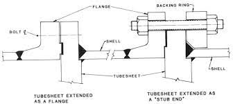

Much more conventional (and industry proven) TEMA tubesheet to shell/head joints look like this:
Could you please explain again why you have put yourself in a position where a unique construction and a unique welded joint is necessary ?
I simply do not understand ....
