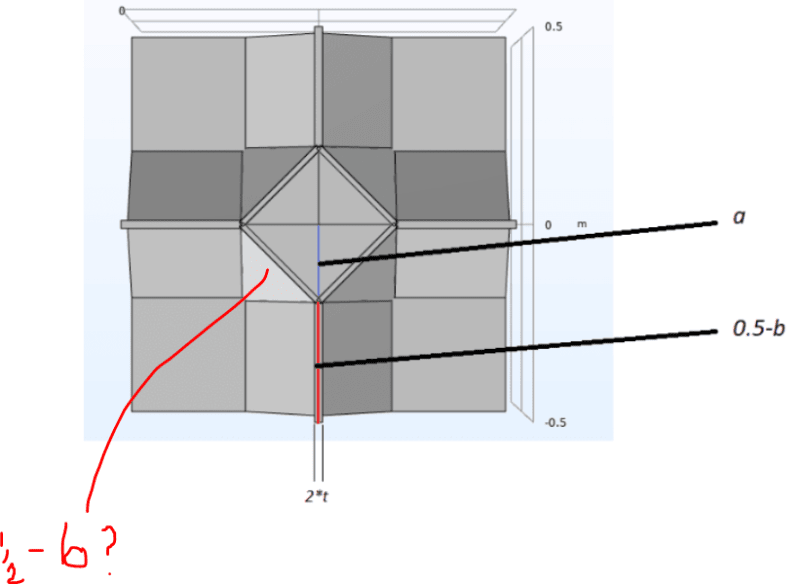

I am trying to find the relation between geometric parameter "a" and "b" using that the volume fraction is 0.2.
Fig 1: This is the geometry I am working with, its symmetric about xyz axis so I divide it into 8 similar parts:

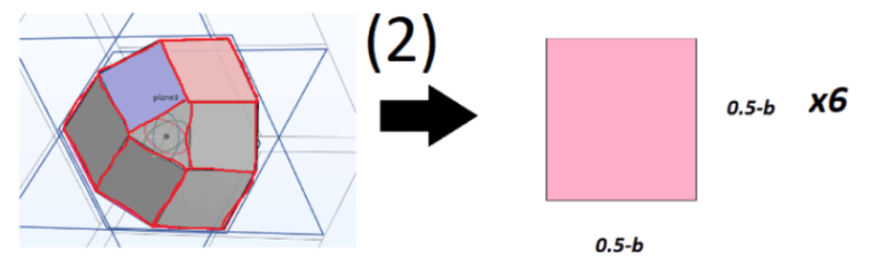

Fig 2: Looking at 1/8th of the geometry - I want to find the volume of this part which consists of:
x3 triangles with thickness t (1),
x6 rectangles with either thickness t or t/2 (2)
x1 triangle with thickness t (3)
I calculate the volume of these parts, add them together and it comes out to be:
5.25*t*(0.5-b)^2 + sqrt(3)*a^2*t/2
The volume of the 1/8th part would be (a+0.5-b)^3 if it was a regular cube:
So the volume fraction would be given as:
[5.25*t*(0.5-b)^2 + sqrt(3)*a^2*t/2]/[(a+0.5-b)^3] = 0.2
My problem with this is that I get 3 parameters; "a", "b" and "t". If I only had "a" and "b" in the equation without "t" for example I could easily find the relation between these two parameters and maybe ended up with something like 0.78*a = b.
Does anyone have suggestions on how I should go about doing this, I am kind of stuck here right now.
I would look at one quadrant of your pattern ...
3 square/rectangular faces with t/2,
3 square/rectangular faces with t,
1 triangular face with t.
Are you getting hung up on the (tiny) area overlap between the faces ?
How about calculating the volume of the voids ?
there a small triangular pyramid on the "inside corner" of the quadrant,
there a 3 simple cubes/rectangular prisms (on the square/rectangular faces),
there are 3 triangular prisms on each inclined face,
and 1 triangular pyramid on the "outside corner".

is "a" the open face dim'n, or the CL?
is the thickness of each web "2t" ? then I'm surprised that you have a "t/2" term
is the length of your red line "0.5-a" ?

at a glance, it seems a=(1/2 - b)/sqrt(2), no?
just replace "a" with the expression using b above (or vice versa) and you have an equation for two variables, one of which is t.
parameterizing some function a(b) would change the geometry
I think there's a typo (or confusion). The whole 1/2 side is 0.5 long, the two segments from be "a" and "0.5-a"; it could be "b" = 0.5-a.
that diagonal length (you call "1/2-b") would be sqrt(2)*a ... no?
it's possible that the shape is "a" (and 0.5-a) on one side and "b" (and 0.5-b) on the other,
so that the diagonal is sqrt(a^2+b^2) ...
or possibly anything !
The more I look, the more issues I see... If a is specified, then the measurement "0.5-b" should actually be "0.5-a"...
Either way you slice it, if those are (6) squares, then "a" and "b" have a known relationship...
I'm just looking at the information in their post, specifically this pic in the OP:
otherwise, the area/volume calculation used (0.25 * (0.5-b)^2)) would be wrong, as would the rest of the math.
OP needs to start again at the beginning and more clearly lay out the constraints.

Edit: It seems onatirec solved my problem by using pythagorean theorem and saying a=(1/2 - b)/sqrt(2), I just have to test it. I wanted to automate this process for different kinds of geometries, which I think might be harder than I expected.

so "a" is the exposed side ? but then b .NE. 0.5-a
