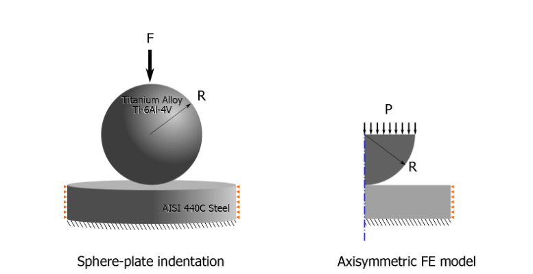

Hello fellow engineers,
I am trying to calculate the maximum contact pressure, the contact radius and the elastic deformation between a sphere and a cylinder base as illustrated:

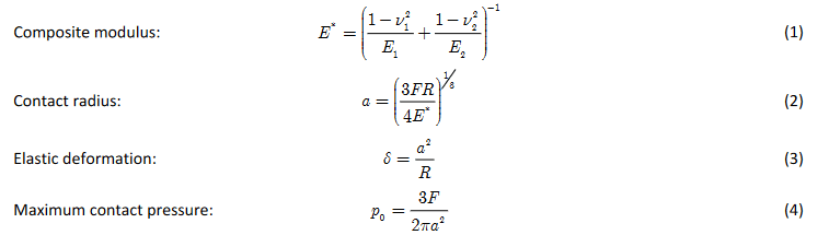

I have been given the following equations:
What gets me confused is the choice of the radius value which should be substituted in the equations. Should it be the sphere radius or the composite radius?
I have run the simulation in Abaqus, measuring the contact radius using the Distance tool under Query by looking at the deformed model with a scale factor of 1.
I observe a large % difference between my calculations of the contact radius and the Abaqus results.
I have checked for common mistakes, units, and still haven't managed to bring this difference down.
Any help would be greatly appreciated.
