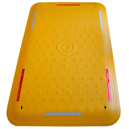

Just buy then. Google pedestrian trench cover.
They make them out of plastic.
Like This

This needs to be a steel permanent cover plate flush with the top of slab - it will sit in a depressed steel angle frame.
