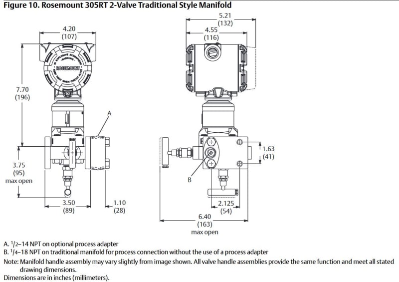

Could anyone point me in the direction of a drawing/document showing a Rosemount 3051CD with traditional flange connected to a 305 2 valve manifold with 1/2NPT process connection?
Thank you.
The optional football (key A) provides the 1/2" NPTF process connection.
