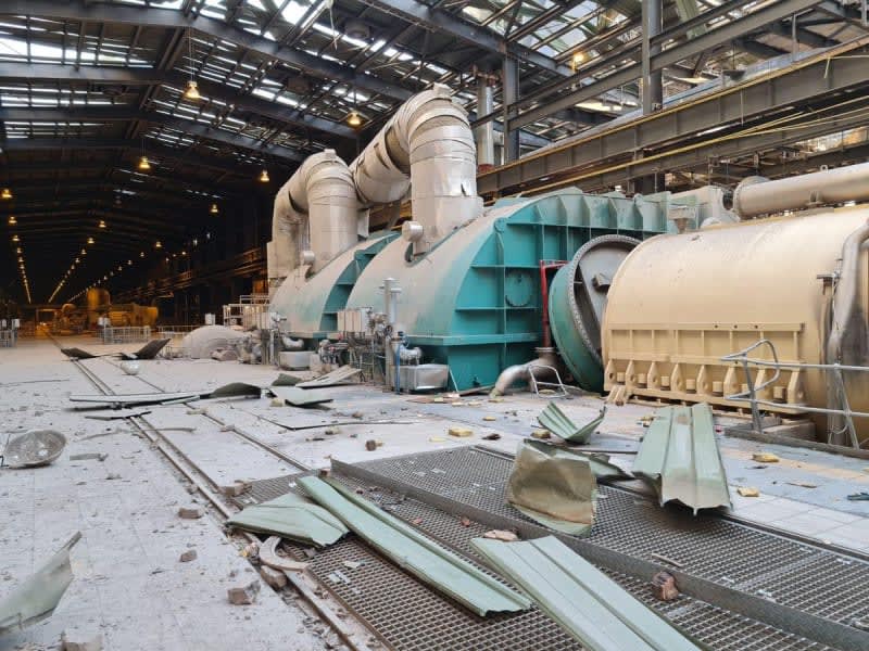

This is what happened when a generator was improperly purged of hydrogen.

That’s exactly what we want to prevent. I want to know what the industry thinks is a safe percentage of H2 gas in the head space before testing. Also we fill the head space with N2 to 8-10lbs through the 1/4”pipe fill valve and regulator and then vent through the same pipe and test for H2.
