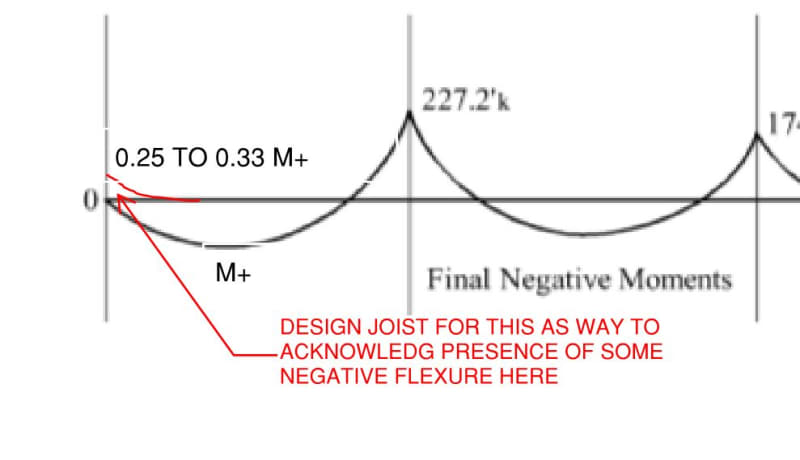

I guess all I'm trying to find is reliable eqn to determine the torsional stiffnes of a RC girder to do my Moment distribution (look at the pictura I'm attaching) the only difference it's that the moments at both ends will not be zero anymore, there's some moment due to the girder torsional stiffness, typically people take it as wL^2/24 as partially fixed beam not 100% fixed but somehow fixed.I'm trying to be more precise and take into account the torsional stiffness of the girder, however I can't find a simple eqn it's not like flexural stiffness of a beam (4EI/L), McGregor in his book consider a beam as a hollow section, gives an eqn for the torsional stiffness would that work? the eqn is Kt=CG/L and C=4A0^2t/P0 Where A0 is the are enclosed by the shear flow taken as 2/3 of the concrete section perimeter, P0 is the perimeter of A0 and t is the thickness of the equivalent concrete tube. Any suggestion woulbe appreciated.
Trying to be "precise" in this case is a fool's errand. Take KootK's advice, and just design the beam for pinned ends, nominal top reinforcement at the ends, then minimum torsional reinforcement for the girder.

@OP: that. Consider these sources of imprecision:
1) Per the graph below, response is related to reinforcement ratios and is all over the map.
2) Each joist will experience a different, torsion induced, end moment because:
2a) The girder will likely be torsionally uncracked in the middle where demand is low.
2b) The girder will likely be torsionally cracked but very torsionally stiff at the ends where direct struts into the supports will form.
Have fun trying to capture all of that and still capturing a shred of profit, right? For the design of the joist, see my sketch below for the "when in Rome" design procedure. Keep in mind that the combined experience of the folks advising your here is probably in the neighborhood of 75 yrs. Not. Our fist. Rodeo.
