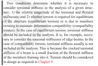

The following clarification has been added in ACI 318-19. However, I don't think I agree with the statement about modeling the torsional stiffness of edge beams (especially in compatibility torsion scenario).
Agreed. That might actually be an outright error given that it seems to be implying that an edge beam is an example of equilibrium torsion. Some might be but the overwhelming majority are not. And your classic edge beam is pretty much the most useful place to make use of compatibility torsion. Not that we get a lot of edge beams to begin with these days...
