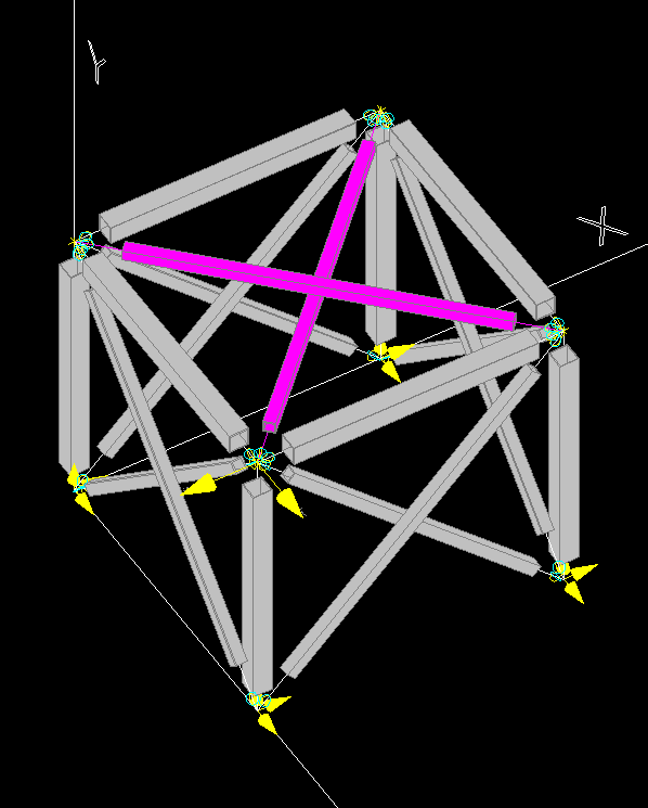

Do all 5 sides (4 sides and top) of a structure need to be braced if all connections are pinned and the supports at the base are pinned connections?
Here is an example to illustrate my question:
Would you say that the bracings colored in pink are necessary if all the connections are pinned? There are vertical loads (Y) and also wind loads in two directions (X and Z).

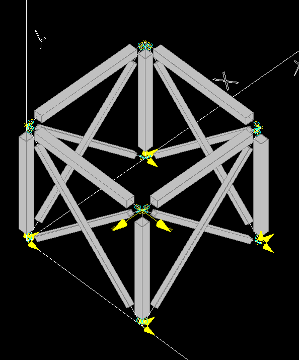

Without top bracings:

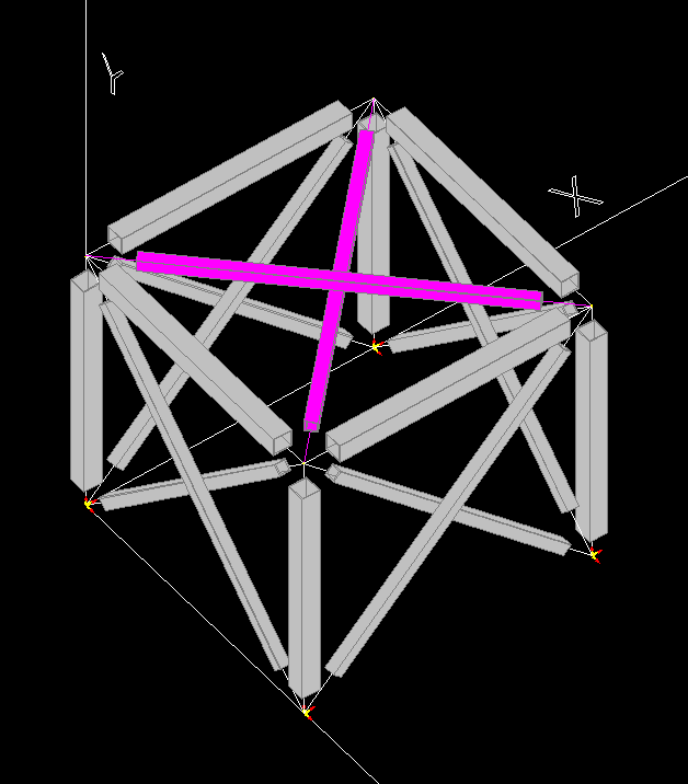

With top bracings:

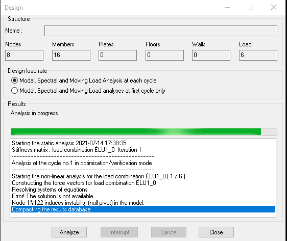

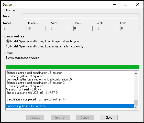

I felt that it should remain stable even without the top brace. However when putting a horizontal force of 15 kN at 45° without the top bracings, the FEM software mentions it is unstable.
It is stable when adding the top bracings.
Details:
Members are:
HSS254x254x13 for the columns and beams.
HSS152x152x13 for the diagonals.
4 m high x 4 m large x 4 m long.
I don't know how it could lose its square shape and form a diamond shape and be unstable without that top brace, because it seems to me like the bracings on the four sides prevent that from happening.
Sometimes it's just model error where you need to allow support to carry torsion eventhough torsion is minimal.
If two diagonally opposite corners rest on pinned supports, while the others rest on rollers, the structure is stable without top bracing.
If two adjacent corners rest on pinned supports, while the other two rest on rollers, the structure is unstable. It can be made stable with the addition of one (not two) pink diagonal at the top.

It’s already stable without the pink members. In fact you could lose half of them and it would still be stable.
The pink members provide additional stability and help keep it square.
