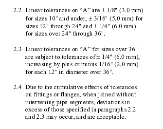

You will reference PFI (Pipe Fabricating Institute) ES-3 - Fabricating Tolerances.
Here is a snippet of 2.4, which will apply for fitting to fitting. You should get a copy, because Figure 1 in the spec is important.
DVWE
thank you for the information, this gives me a guideline to go by on the few piping assemblies that we weld together
will look into purchasing the spec.
