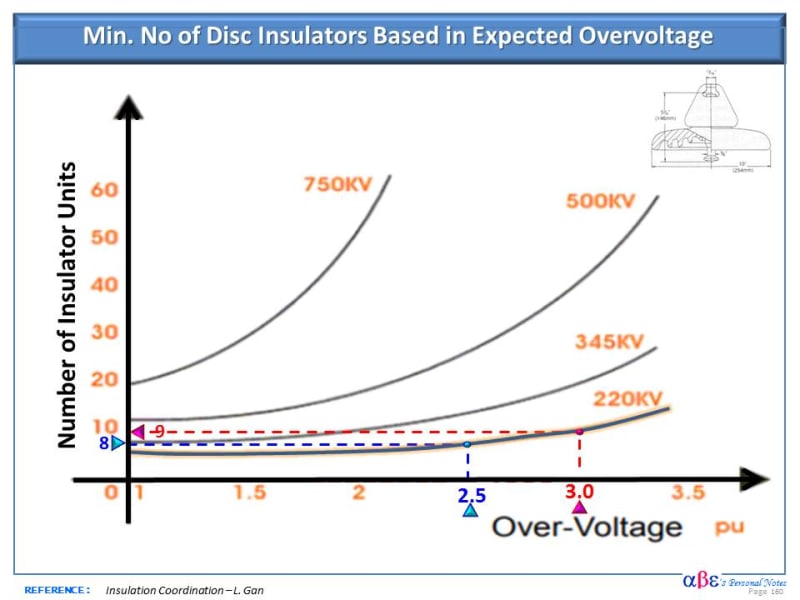

like how to find number of polymer disc required for a 220 kV suspension and tension insulator string?

Polymer disk?
Below is a simplified curve to select disc porcelain insulator and a link for a typical transmission composite suspension insulator
The number of disc porcelain insulators is also a function of the pollution level of the particular site, altitude among other parameters. For normal operating conditions, the minimum number of disc insulators is usually around 8 to 9 units as shown in the following curve.
