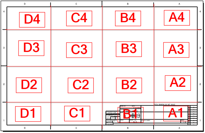

Can you post your complete code here, that will be of great help, I am looking for a code that will create a Table in complete sheet with zone name in each cell like from one corner A1 to end corner L40 . This code will help me to create table based on various sheet sizes.
Refer the image attached for my requirement.

Hello
If you don't know how to create a script to do this, it will be much easier (and faster) to create a 2D Component (ditto) to insert in a drawing and see the grid created with your own rules.
Is much easier to use the native CATIA tools and sometimes much faster than developing an application.

Hello Ferdo,
Actually I want a macro that will create a bigger table like this, this will useful for me during Drawing revision recording and zone specification during each time. I am expecting a tool that will create such table that will be helpful for a moment during revision recording and will create another macro to delete it or getting hided.
I hope you understood my requirement.
