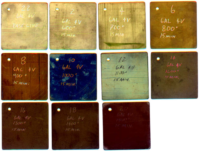

And for more fun... done by a high school student in her father's USAF HT shop on a weekend for a science fair...
Ti-6AL-4V sheet metal coupons exposed to oxidizing-air heat, for 15-minutes at various temperatures... in a small furnace is a USAF HT shop ~1997. Take my word for it chocolate brown is bad: 'crunchy-brittle'
