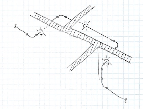

And hopefully you won't have stuff like this, which appears to be a standard for 100+ year-old pulp mills in Maine:

Gator, I have a couple of pipes that look like that....and some of my handsketches resemble that too! I have people here that know the pipes quite well and will help with checking the drawing over when it's on paper but the grunt work of pulling the information together will be done by people who are just getting familiar with the system still (including me, it will be a valuable lesson though).
