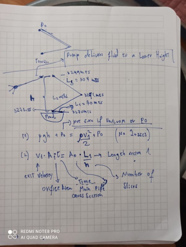

Dear Team,
I need to calculate how much it takes to drain a 36" full pipe, in three main sections with different slopes. We have a 16" full open valve to drain it.
I do the calculation dividing the sections in several parts, estimate the velocity and then the volume flow trough the orifice. But this gave me a time of 11 minutes! i am not considering friction losses because I would need to estimate lambda in each part.
Can anybody give me a clue?

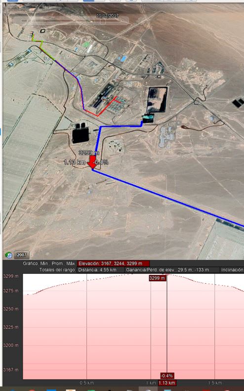

Sorry LittleInch, i will show a diagram as soon as i can. When the pump stops, it leaves a volume in the line,i just assumed full pipe, from 3270 mts to 3299 mts at the top. The 16 inch valve is close to the pumps (at 3270 mts, where the blue line starts), so when I open the valve it returns the flow, from the 3299 mts to 3270 meters height.
In normal conditions the pump, wich is close to the pond, where the blue line starts, delivers flow to a point that is beyond the red arrow, passed the 3299 until a point that is at 3270 mts.
So, when the pump shuts down, the flow from the upper hill and the remaining flow on the line, returns to the pond level, wich is at 3270 meters, using a 16 inch valve. The last 70 meters, the flow is almost horizontal (1 mts height difference), so maybe that's is the bottle neck in the draining process.
I need the time estimation, because we need to do maintenance in the line.

Yes the pipe will always be full from the pump to the high point.
I can only assume therefore that the 16" valve is normally closed and this is only open for drain down.

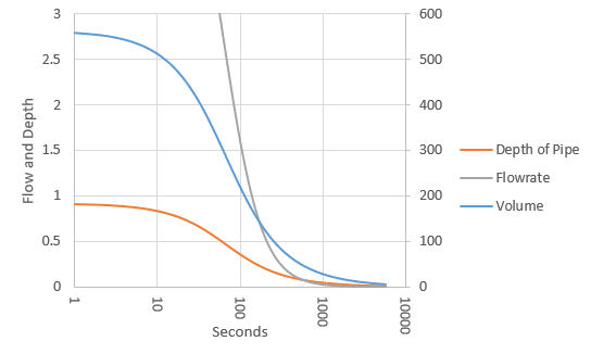

I took the five minutes to run an iterative Hazen Williams flow calculation and based on the information provided it will take 89.75 minutes to get to 0.01 m of flow in the pipe. It will still have 6.23 m3 of water left in the pipe and flowing at roughly 0.001 m3/s.
The math portion explained
Q = V A
A = D2 / 4 x ( θ -1/2 sin(2θ) )
θ = cos-1(1 - 2y/D)
y Depth of water
D diameter in this case 0.91 m
V = k C R^0.63 S^0.54
K = 0.849 for si
C H-W Coefficient assumed 140 for this one
R hydraulic radius
R = D / 4 x (1 - Sin(2θ) / 2θ )
S = slope m/m in this case 29m/859m
I first ran the formula assuming a full 36 inch pipe to determine how many m3/s would be coming out.
Then I figured out the total volume of 859 m of 36 inch pipe and subtracted 1 second of flow determined.
I then iterated the y depth of pipe with the new volume divided by the total volume
5385 seconds later y = 0.01 m

Shouldn't froud number of a pipe flowing at a slope of 1/70 m still stays above 1 indicating supercritical upstream control except for a portion where the pipe is closer to full does the froud number drop below 1, but that should last less than 100 seconds.
Chart of outputs Flowrate starts just above 5

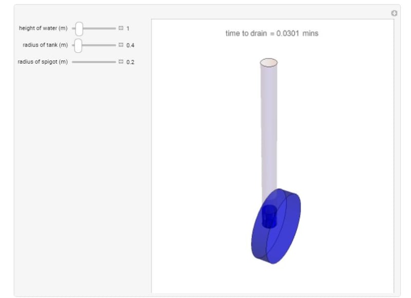

the flow is limited by the orifice, you need to use an orifice equation - not Hazen Williams
I think that a way would be to use an orifice equation until the last 70 meters, or until we have a height of 0,4 meters (the orifice diameter, 16 in). Then use Manning to the remain flow. And Add the two times
I looked up the orifice equations (Flow through Partially Submerged Orifice) and found that in this case of 29 m of head a 0.40 m orifice will have 10 m3 left in about 600 seconds meanwhile the hazen williams 0.91 m pipe will have 10 m3 left in 3000 seconds. Granted the orifice equation does start with a lower flowrate at the beginning but after a specific amount of time HW will tell its slower assuming you still have a uniform partial flow condition over the entire 859 m length. You could join these methods and even recalculate the length of pipe to determine the new average slope, or you could be confident that after half an hour the majority of the volume and flow will be gone and it will continue to trickle out for hours.
