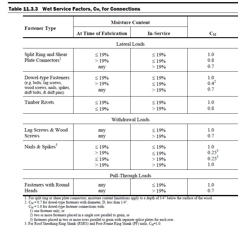

You're missing wet service factor here, I think it reasonable to at the very least adjust Z' by 0.7 for wet service conditions during installation.
Looks like a great application for a carbon fiber wrap. I am sure Simpson could help out in this case.
Fair enough! I wasn't necessarily meaning to check everything, and based on the picture, it at least looks dry.
Depending on how you interpret that table and the range of potential moisture contents at fabrication and in service, it's possible CM = 0.4 might even apply.
Ok, so with CM = 0.7, we're down to a lateral force of 40 lbs.

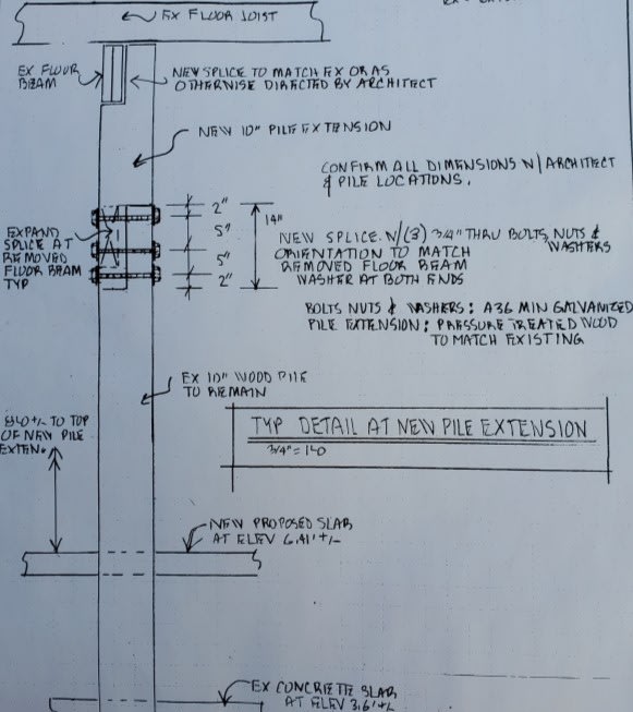

Well here's the engineered detail that I will share. Not that it will make a massive difference in your calculations.
There are no other foundation/ ground floor lateral systems for 95% of these houses in NJ. Their lateral resistance is solely based on the number of piles in each row. For houses that are more rectangular and are only 3 piles wide, those are noticeably racky (is that a word?) in the short direction.
Typically if a house is going to be higher up I'll specify 12" piles. Houses not that high up, 10" piles. Foundation lateral design complete.
@Eng16080,
The center of the bolt group would be 2'-6" +/-
Assume the middle bolt takes the shear.
So M= 2,500 Z = 2500/1 ft = 2500 lbs
So the bolt loads are 2,500,1000,2500.
Still overstressed significantly but in practice would probably survive.
1,000 lbs shear at the top of the column is probably unrealistically high
edit - looks like the bolts are 10" apart so the numbers are little higher!
