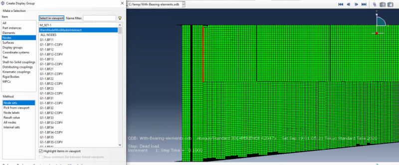

In thw Visualization module you can check the node sets generated by Abaqus and containing nodes that were tied and those that were not connected. Check them and make sure that connections were established between the whole surfaces, not just partially. It it looks fine then there’s nothing to worry about.
