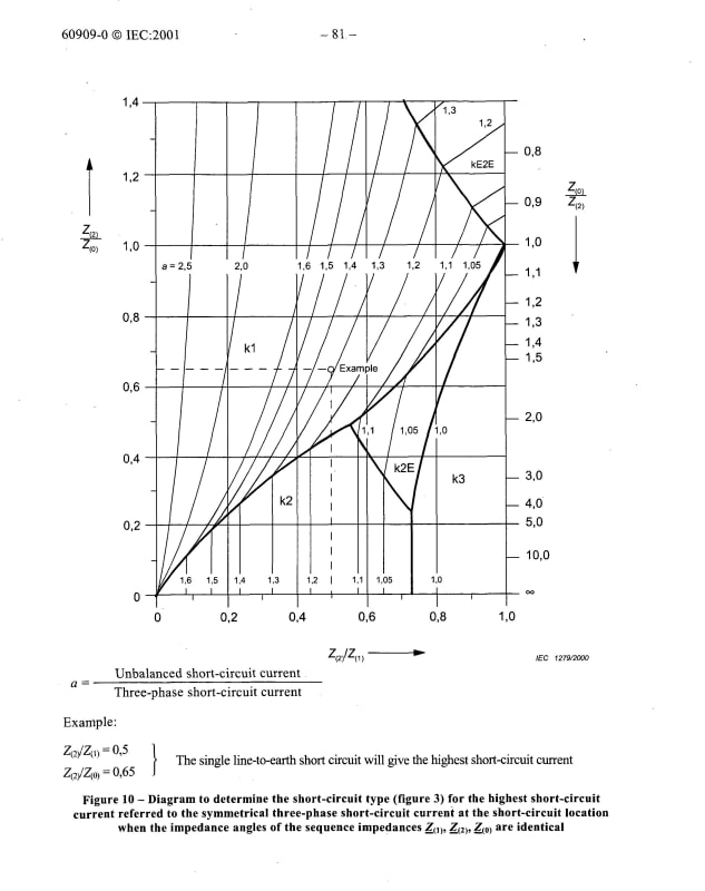

According to IEC 60909-0 the maximum current depends on Z2/Z1 ratio as shown in the attached image.
The symbols are as follows:
k1-the area in which SLG is the highest
k3-the area in which three-phase short-circuit is the highest
k2E=the area where two phase short-circuit is the highest
kE2E=the area where two phase to ground short-circuit is the highest
Depending on the Z0 value of the transformer (for a Dyn1 the value of Z0<Z1) the bolted 1-ph to ground fault
current right at the transformer low side terminals is much higher than its 3-ph bolted fault current.But what ever the cable
or O/H line impedance offered between the low side bushing terminals and the bkr location will lower it.Therefore select the bkr
accordingly. Use your good engineering judgement because ETAP/SKM/EASYPOWER are all just "TOOLS" only.
