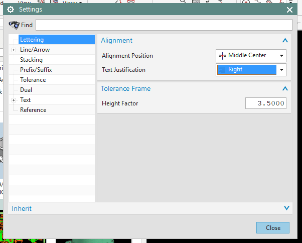

Threaded Holes Callout
You need to right justify it.
rmc on dimension -> settings -> lettering -> text justification -> right
Jerry J.
UGV5-NX11
Alternately, you can try keeping the left alignment and adjusting the leader line vertical alignment to "middle" or "bottom" to see if it helps.
