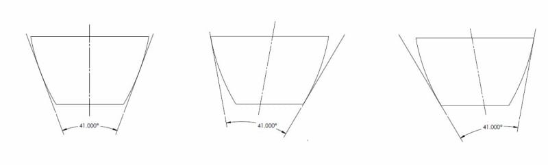

An axis can be derived from any geometry with symmetry (or arbitrarily on any geometry for that matter), that doesn't mean evaluation of an applied position tolerance is simple.
Cones are not FOS and do not have a defined UAME. The axis required for evaluation of RFS position tolerance is that of the UAME, and since cones do not have a UAME this leaves the consideration for what boundary/axis combination to be utilized open ended. I would say in this case any boundary could be utilized which makes contact with the feature and therefore any range of axes can be chosen if not specified (that is - if we assume that position applied to a conical feature as it is, which without a special note I would say is questionable already). Inclusion of a gauging/restraint requirement or fitting routine would at least remove some of this ambiguity about what boundary to utilize - unless you are okay with any boundary which makes contact with the feature.
Below is an example of three boundaries on a conical feature with form error making the same amount of contact which without specification otherwise could all be valid boundaries/axes. This and the above also applies to a cone as a primary datum feature as shown in Y14.5-2009 fig 4-44/4-45. Unlike a FOS the minimum or maximum (for external/internal features respectively) boundary cannot be utilized because there is no minimum or maximum.
Perhaps some extension of the candidate datum concept could be applied here, however I think this would leave some room for interpretation that would not lead to a common standard method. A tapered feature with nominally flat/planar sides would be easier to apply this to.

Using these definitions, the conical feature (with or without the flat surface at the tip) is certainly not a feature of size. If you imagine the true profile starts out roughly aligned with the actual feature and an offset envelope progresses toward the material, it never reaches a point where it can't progress further. The feature just gets pushed away from the true profile.
The classification of a cone as a non-FOS precludes I think the typical use of RFS position on a conical feature without special notation about how a boundary/axis is to be established as the definition of UAME is insufficient (it does not exist for this shape).
If a conical surface is used as a primary datum feature as shown in Fig. 4-44, the datum feature simulator is coincident with the true profile. In this respect, a cone has more in common with a plane than it does with a feature of size like a cylinder. That doesn't mean it can't establish an axis, just that it does so in a different way.
This equivalence means that the datum feature simulator may as well be a solid piece of material. A conical socket with an opening diameter of roughly 0.9*F should do the job. Datum simulation would basically be a matter of pushing the part up against the simulator axially.
I don't disagree with this evaluation of a cone as a primary datum feature, however the last bit (bolded) I think needs further clarification - see the end of my previous post (26 Sep 19 18:44). It certainly can be simply pushed up against a fixed simulator however that doesn't solve the issue with form error as I noted as multiple orientations are possible and as I said I'm not sure the candidate datum concept provides a simple solution to this - perhaps I'm not seeing something though.
