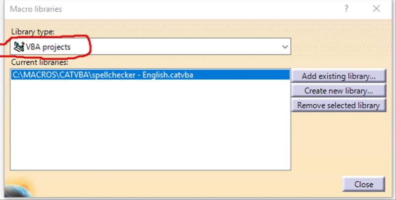

Thanks for sharing the script. But if I open that script at some places letters are repeating . I am not able to run it. Is there anything I am missing before run like debug the script.if the script is like direct use it Will be very helpful. Please help me in that.
Thank you once again
you need to run as VBAProject

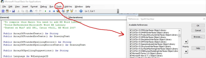

Some of our installs had problems with the references.
look in the Catia VBA editor (Tools>References)
Uncheck any that don't look right.
I believe they have exclamation marks if they are unfound.
scroll through complete list.
ignore the "-English" version in my file name.
I changed setting in the file, so it defaults to English.
