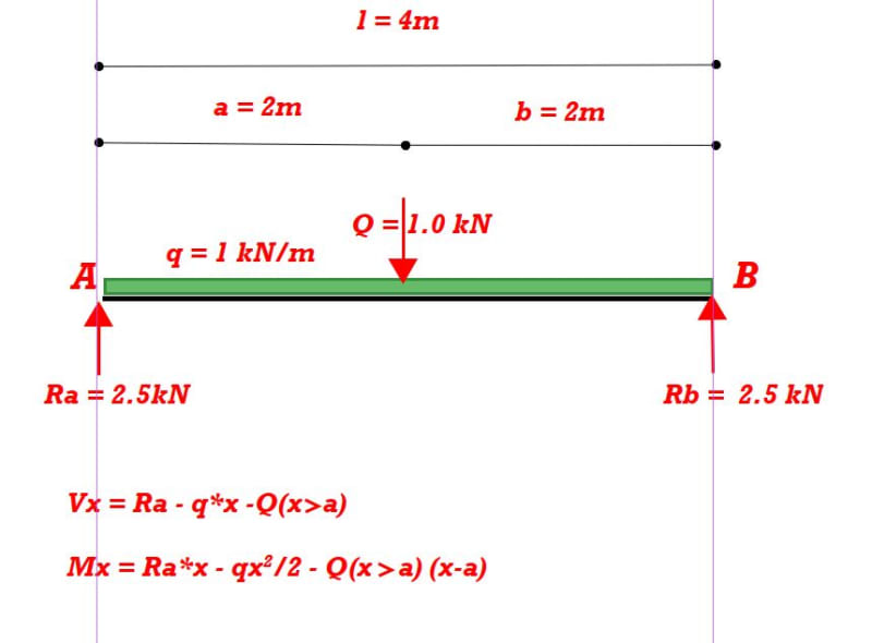

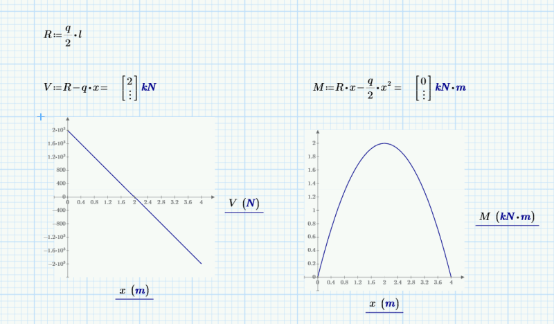

Im trying to calculate the bending moment and shear force depending on the distance x along the beam.
I tried making "a" into another matrix but then its either not a scalar or it says the number of rows and collums isnt the same.
I saw a similar problem on here but didnt quite understand the solution.
Please help.
Best regards
Mathias
Your description of the problem is unclear. Draw a sketch showing the beam, all forces acting on it and all terms used in your post. A sketch is worth 1000 words.

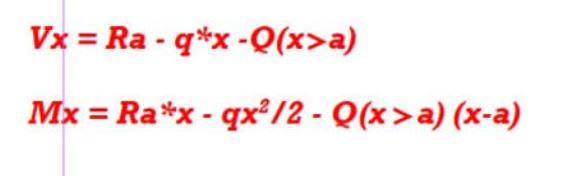

I think I understand the problem you are trying to address. See below. You can simplify the expressions for Vx and Mx, using the boolean expression (x is greater than a) but I don't know mathcad, so can't help with that. Should be pretty straight forward.

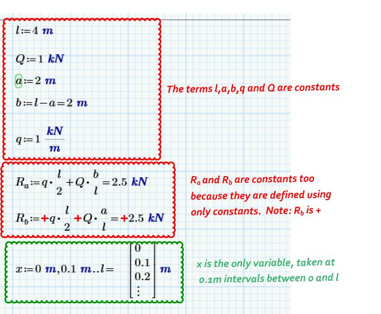

Okay, i will try to explain the problem better.
Im trying to compare x to a.
x is vector, depending on how i define x it has around 45 values. If i put the pointload in the middle of the beam, around half of those x values are greater og equal to a and the other half is lower or equal to a.
I think i either need to create some sort of loop, because it needs to compare every value of x with a.
Or make "a" into a vector (picture 2) and compare each row to each other. So x value 1 compared to a value 1 and so on.
Im not fammiliar with mathcad enough to make it do so.
It might be my math skills aswell that is stopping me from compleeting it.

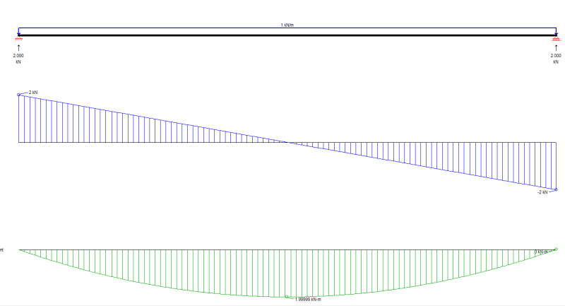

I have attached 2 pictures with a uniform load (based on the x and q definition from the first picture), and a DSNwinbeam screenshot (with inverted moment diagram).

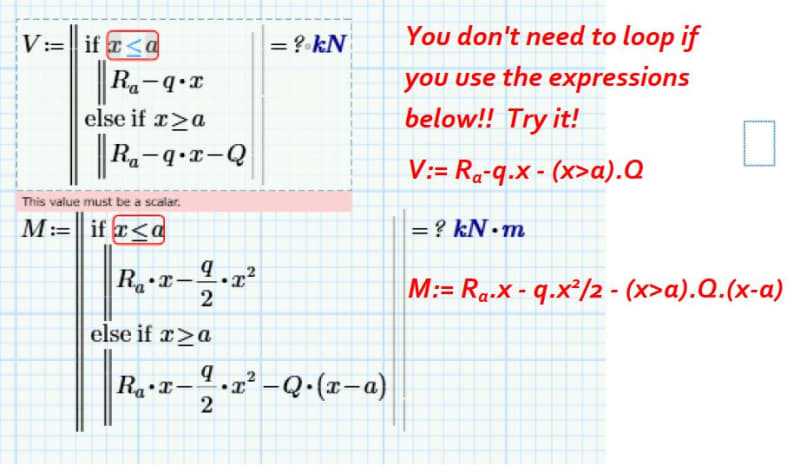

Neither am I, but I gave you an expression for Vx and Mx in my previous post which you have completely ignored. Try typing them in as I wrote them. Each expression contains a boolean variable which can take on the value of 1 or 0, depending on whether the argument is true or false.
BA,
While you are correct in your math, that's not what OP is trying to do. They're using "x", a 41-element vector of positions spaced 0.1 m apart and trying to solve the equations one position at a time.
Mathcad has a facility for defining vectors, shown at the center of OP's first image x:=0 m, 0.1 m ,0.2 m..L, which is fine, but his program, at the bottom of the first image is comparing the entire array of x-values to the mid-point value. That does not work in Mathcad, nor in real life. As in regular math, array elements can be accessed through indices, which the OP hasn't used.
Note that the OP has already defined your equations in the two programs at the bottom of his first image.

I looked at mathcad supports website and didnt get much info besides that they call "x" a range variable.
I saw a similar post where he reached a solution, but i dont quite understand it.
It seems GregLocock is on the right track, i just dont know how to do it in mathcad.
It should be possible.

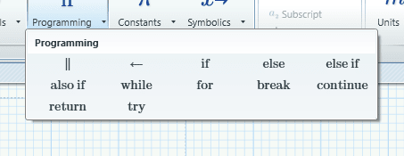

I have attached the programming options in mathcad, in case that might help.
sorry if i started this thread under the wrong segment.
See 10 Jun 22 19:39 in the post you linked to - note the use of the "i" range and the reference in the following formulas as a suffix to index as in xi with the result assigned to Vi and Mi
I'll give it one more try. If this doesn't convince you, I give up.
Yes, you are correct that no program is necessary, but I assume that the student was tasked with solving it programmatically, as a learning exercise.
Your approach, but no guarantees about correctness, since the results show a kink that shouldn't be there. Nevertheless, some of the structural ;-) elements of the sheet are usable in the programmatic version
