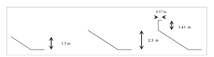

I'd like to ask an question about bund shape design.In order to contain the chemical imperviousely during storage tank crack or catch a
fire. the bund are suggested to design like sea wall with slope(see the attachment), this can be stronger than vertical bund wall. As the incident investigation report in Buncefield incident, the bund cracked due to various reason.
Are there any standard that require the bund shape design? thank you!

I'd like to ask if there is a design standard for the shape of dike, such as an angle, not vertical wall, to better contained the liquid
if there is tank crack happened. thank you!

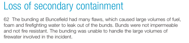

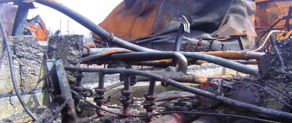

Thank MJCoin! The document you recommend is pretty useful. I'm not designing a chemical dike, I just want to learn something about the
dike design since I found the Buncefiled report that the dike was not designed with metal waterstops and also catastrophic failure of the
walls at pipe penetration.
So I tried to get to investigate which kind of dike shape design is safer fot chemical storage tank, and compared with my several plants,
if we can offer better dike design proposal selelction when we design new chemical plant. So i found the new kind of design described
above in an article, the author recommend chemical storage tank dike design like sea wall.
