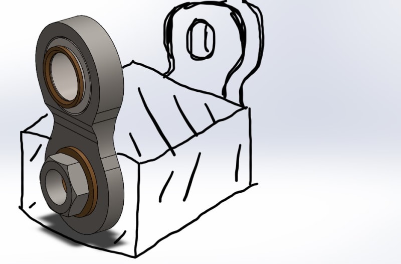

Hi All,
I have a part that looks like a figure of 8 with two holes, similar to a chain link.
The holes need aligning with one another but i'm struggling to decide how to apply a tertiary datum to lock any rotation - see attached.
I don't want the holes wandering off so the wall thickness get reduced.
See attached picture.
Any help would be great.

Yep could do that, although I liked the idea of using a profile tolerance and simultaneous requirement to control rotation as suggested in an earlier post.

What kind of fit is there to the stud when bolted up? Is there clearance under all conditions? If so B should be primary.
Presumably if there was interference then B should remain secondary? Is this because an interference fit on the stud would not allow the part to 'tilt' and obtain a 3 point contact against the mating part?

R1chJC,
Essentially yes, though I find it more useful to think of it in terms of constraint of degrees of freedom. If we take (z) to be normal to the planar surface, then in the theoretical case you presented (press fit/interference between the stud and the bore as datum feature A) then datum feature A would constrain translation in (x,y) as well as rotation (u,v), and the planar datum feature B would constrain translation in (z). However, in your actual assembly (clearance between stud/bore) planar datum feature B would constrain translation (z) as well as rotation (u,v) and datum feature A would only constrain translation (x,y). The application/precedence of your datum feature references in your DRF should reflect this.
That being said, transition fits (clearance/interference between features depending on where they are produced inside their tolerance zone) as well as introduction of forces on flexible parts (ie: any real world part - nothing is truly rigid) can make it difficult to determine what features constrain each DOF. The only thing you can do at that point is to as closely determine which features contribute the most to the constraint of each DOF and possibly include a specification for restraint of the part during measurement to replicate the condition during assembly, if necessary.

R1chJC,
I too would likely prefer an approach using a profile tolerance as part of a simultaneous requirement, with B as the primary and possibly the only datum feature. A directly specified minimum would make most sense if wall thickness were the only concern, but I imagine that's not really the case.

R1chJC said:
I'm struggling to see how one might be preferred over the other in my application.
You could look at it from this perspective:
To avoid this kind of problems, the set up of the part for inspection (i.e. the order of datums specified in a feature control frame and their material boundary modifiers) should mimic real assembly conditions as close as possible.
R1chJC said:
Yes, clearance in all conditions - but only a few thou.
When estimating the amount of clearance, did you take potential perpendicularity error between the dia. 1.500 hole and the abutting face under consideration?
Based on your 3D sketch, it seems like addtional bushing is pressed into the dia. 1.500 hole. When estimating the amount of clearance, did you take under consideration the fact that the hole in the additional bushing may have extra coaxiality error relative to the hole in the part that is being discussed?
