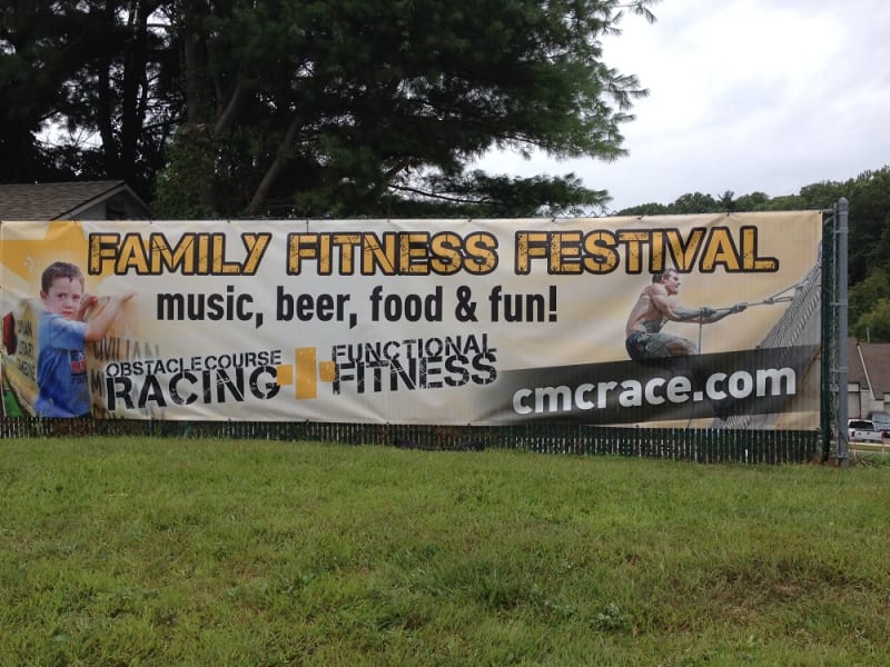

For a banner that size, it is not practical to span with banner material alone. Provide a structure to support the banner. This is a small banner with structure behind:

For a 40' high banner, a structure is required to resist the wind load.
