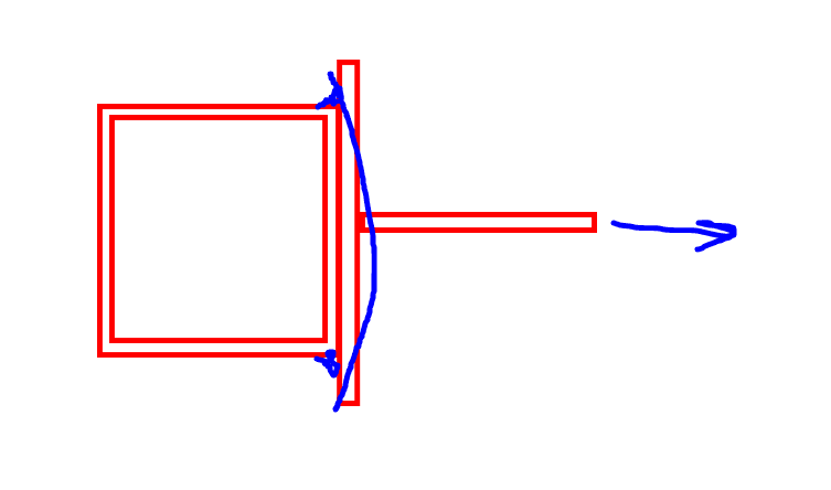

@ JP / human909,
By extension of the same principles, do we then have concern for the kind of connection shown below? It seems as though we might. This case is much more common in my practice as a way to bypass potentially thin HSS walls that would otherwise fail in flexure. I've seen this as a shear + axial connection but, also, as a predominantly axial connection in the case of vertically braced frames. If it's bunk owing to the weld prying business, I'll need to put the brakes on that in the future.

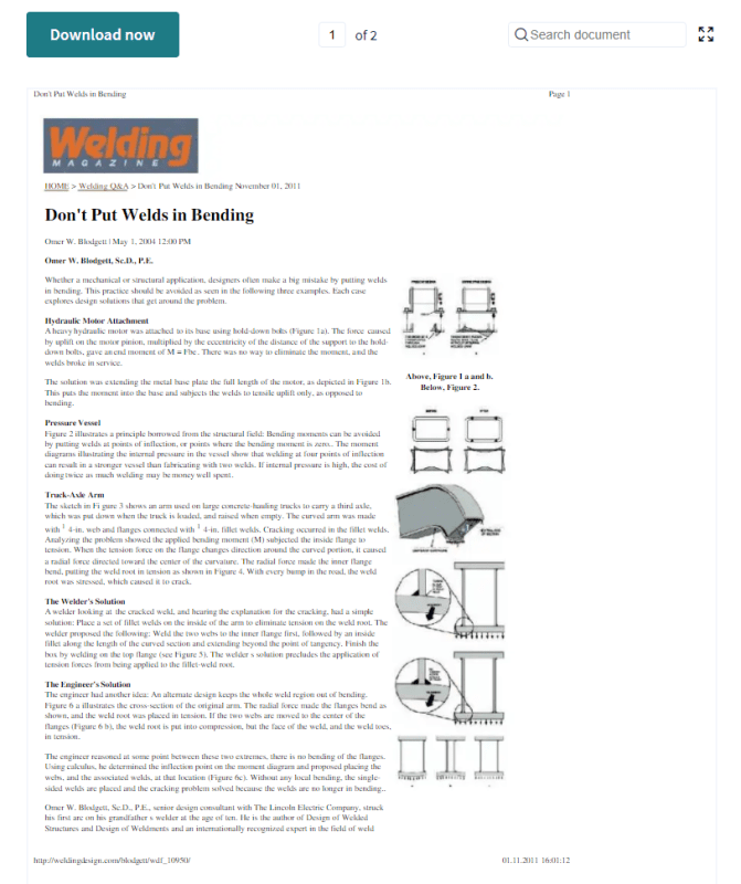

I used to have access to the article snipped below which, I believe, did a good job of elucidating this subject. In particular, the box beam example.
Good question. Personally my gut feel on the connection that you have shown there doesn't give me confidence due to the weld bending under axial tension. But that is just my gut feel.

It would be nice to read the Blodgtt article. At the bottom right, it shows a box girder with welds either outside the web only or both sides of the web. Is the both-side weld the solution or was it pointing out that it isn't? Seems to me that the weld needs to distort to the deflected shape of the flange in either case.
My approach would be to stiffen the flange (of the box beam or KootK's T-connection) to make the slope small compared to what the weld can tolerate. A weld pulled transverse to its length elongates about 1mm before snapping AFAIK. So say 0.1 to 0.2mm across the leg dimension = 1/60 to 1/30 slope as a starting point for discussion. Static loading only per Human909's caution.
More cautiously, keep well below the 0.1 to 0.2mm yield deformation under service loading.
Yes, I tend to think the issue applied for that case as well. However, if the Tee were welded fully across the tops and bottom on the Tee (instead of just the sided) then you move into a better weld configuration. But, it probably ceases to have the rotational ductility to be called a shear connection.
That's the real dilemma... getting a weld configuration that works without overly restraining the connection.
Also, to me, the connection is the same whether it's a Double Angle or a WT, provided the welding is the same.
Coming back to KootK's question. It is all well and good to be armchair engineer and criticise his connection for being unideal. But is is really so unideal that it is cause for concern? I think Steve has best articulated it, though I'd expect most of us had already come to that conclusion, we need keep the plates stiff to limit the weld bending.
The simplest answer I come to is to use thicker walled sections or significant axial connection. There is an interesting article here.

I'm sure that the failure noted in the Blodgett article had a great deal with the component being cyclically loaded in a way that would exacerbate fatigue issues.
If you think about it, even an uplift base plate on a wide flange column is likely to see some bending in the fillet weld roots at some locations. Something that I've long wondered about is the extent to which a two sided fillet weld alleviates this condition (or doesn't).
