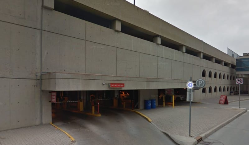

I've used 12" HC to span 40' for parkade structures.
Got a load table for that? A parking garage is a lot different beast than a water tank. Good luck with those, I refuse to park in precast garages.
Besides, 16 metres is about 52.5 feet.
I wasn't thinking of the base, only the roof... for base, I'd go with reinforced concrete, only, with supports as required; there would be no long spans. The parkade has been in use for over 40 years... we don't have seismic conditions; I've parked in it numerous times. I don't remember what the span was, but it was more than 40'... Parking Roof live loads, here are 50 psf, and snow roof live load is 36... I'll see if I can find out what the span is.

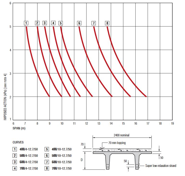

As a start Can I start with this figure [LONG SPAN ROOF MANUAL]
But try to increase the slab thickness & reduce the top flange width to resist the expected shear loadings ?

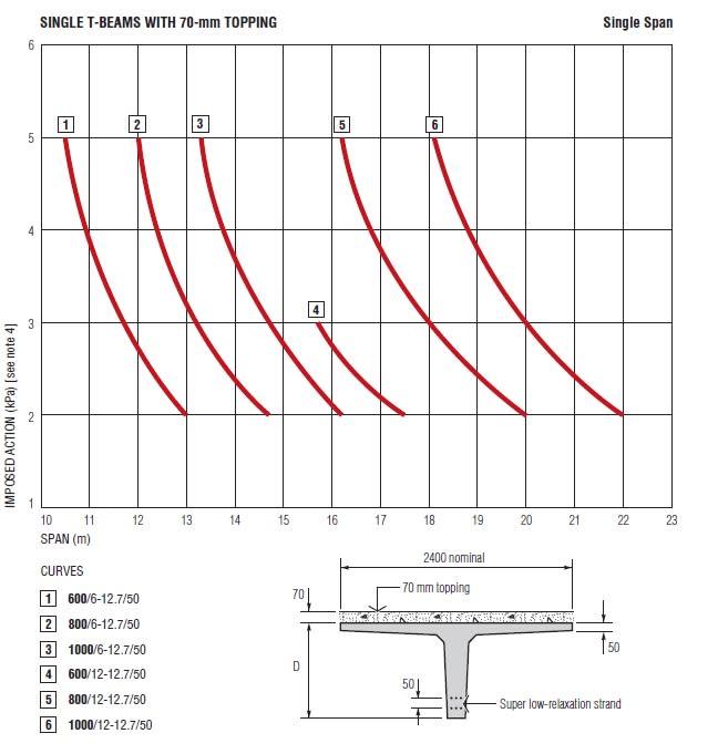

The scale on the figure only goes to 5kPa live load, which is not enough for your application. Furthermore, in seismic areas, prestressing might not work due to load reversal.
Without earthquake resistant design requirements, you should be able to calculate the required prestress (done with post-tensioning for loads of this size) with the basic T-beam model, where several T-beams are positioned adjacently. Start with 5-6 meter wide flange, 1000mm deep web, 300mm thick flange (slab) and prestressing in one direction and work it out from there. If earthquake resistance is needed, deep web steel girders with a concrete slab composite connection (requires shear studs) is probably much more suitable.

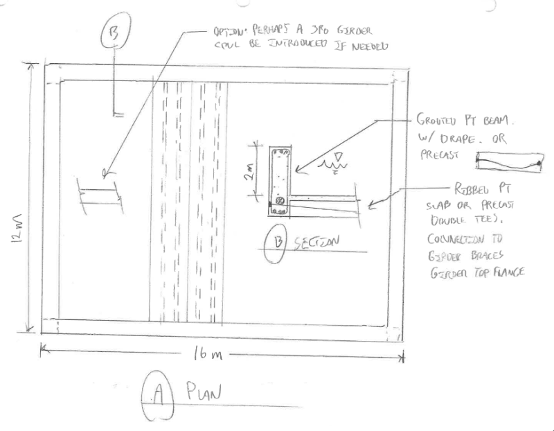

Another option to consider:
1) Could be precast or CIP.
2) Takes advantage of the depth of the tank which is a smart thing to do if it can be done.
3) I'm fine with prestressed concrete in high seismic areas as long as it's done skillfully.
4) An advantage of this relative to steel trusses is that you get automatic bracing of the top of the girders. That can be problematic, although certainly not impossible, with steel trusses.
Will your tank have a roof of it's own? I've assumed that it won't.
