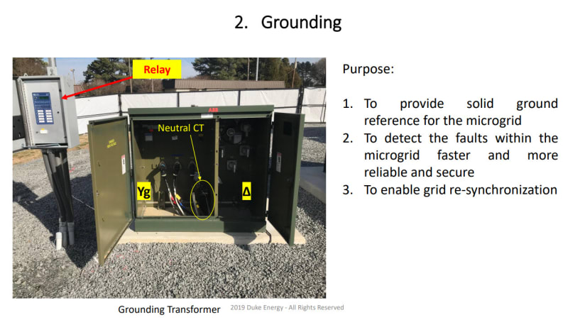

After seeing badservo's response, I would like to clarify that we I say grounded I am referencing the neutral as in a floating-wye versus grounded-wye. Apologies for that.
I found this PowerPoint slide mentioning using a grounding bank to provide the ground reference for synchronizing an inverter-based generator.
Sales technobabble.
