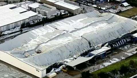

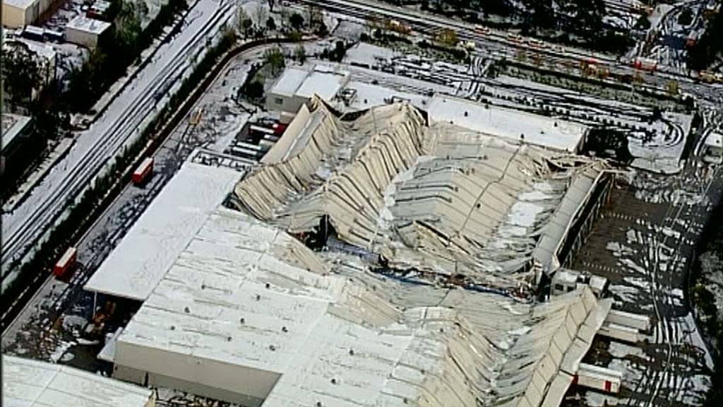

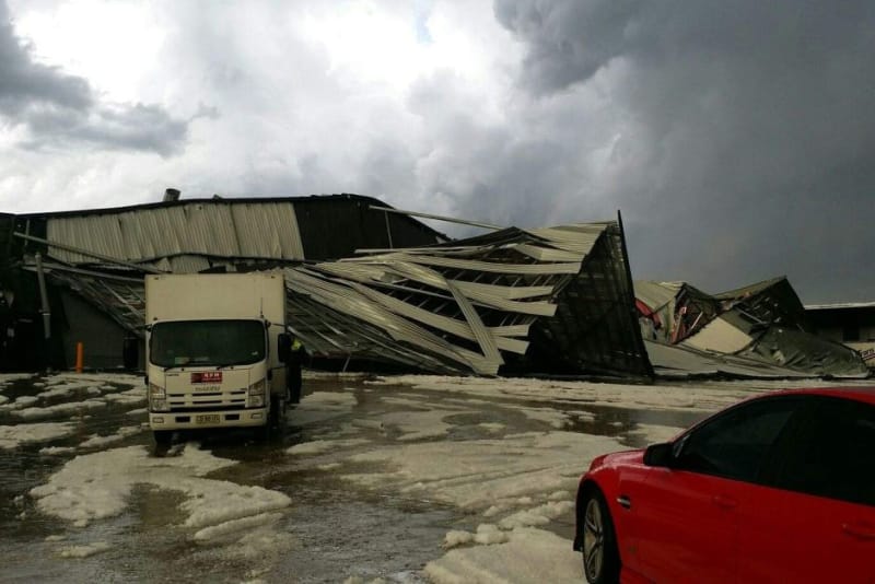

Sydney, Australia copped it pretty bad this week in terms of storms and flooding.
This afternoon was particularly bad with large amounts of hail. Several steel framed buildings collapsed due to accumulation of hail on the roof.
My question is how did the hail accumulate? Surely the pitch of the roof would prevent this? Pictures below.
All look like "pre-engineered metal buildings" (PEMB's).....those structures are severely "optimized" (structurally) and were likely not designed for such accumulations. They typically have a 1:12 or 2:12 slope, so they are relatively flat and the localized deflection of the panels and purlins exacerbates the issue.

Those roofs are relatively flat, with steel roofing. Only pitched enough for water to run off, not hail. We do get big hailstorms in many areas of Australia, and they invariably lead to failures, but not usually of this magnitude. The most common type failure is filling of box gutters, then when melting starts, water runs back into the building.
Ron, I doubt those buildings are PEMB as you think of them, because we don't have much of that in Australia. But we do have all too many substandard old warehouse and factory structures which are even worse than your PEMB structures. As snow load is not an issue in most of Australia, hail is often forgotten as well. And many buildings are "designed" for only .25 kPa live load (about 5 psf).

The somewhat separate issue of roof drainage, especially involving any kind of internal drains, also needs a fresh look. This is sometimes left to architects, but in recent times hydraulic consultants are frequently involved. The roofs which collapsed in Sydney had internal gutters.
