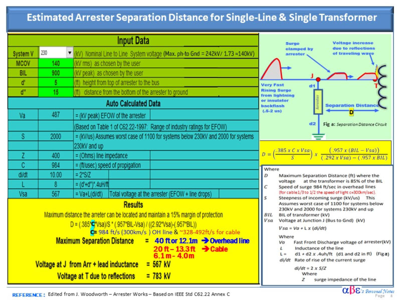

Yes, both the IEEE Std C62.22 (see annex C) and the IEC Std 60071
Max. Protective Distance:
a) IEC STD: [highlight #FCE94F]L = (v/2S)x(LIWV/Ks–Ures)[/highlight]
Where: v=surge speed (300km/s for OH line & 1/3 to 1/2 for cable); S= max. steepness of the rise of an overvoltage wave;LIWV=lightning impulse withstand voltage;Ks= Safety factor for insulation(1.15 outdoor & 1.05 Indoor) Ures = arresters residual voltage.
b) IEEE Std C62.22: See example with approx calc of the protective distance.

basilasq, then you may ask what is wrong with longer cable length? It is for better. Please note Annexure C calculation in C62.22-2009 is not valid for cable connections(See clause 5.2.3.4.2)
Now let us consider why it is suggested to reduce the distance between SA and equipment terminal. When SA discharges, a huge current flows to ground through the down lead from SA to ground. Consider the rectangle between this path + transformer tank surface as opposite sides and the connection lead between SA terminal + ground as opposite sides. This is the flux window from surge current that induces a voltage on tank surface that adds to protective level of SA.
So solution in your case: if the cable is with metallic sheath, at SA end, connect the down ward lead from SA to this sheath. At receiving end, connect this to tank earth. Otherwise run a grounding lead along with cable to achieve this. Net target is to reduce the area of rectangle as explained in above para. Rectangle between cable, grounding lead.
I do believe that the protective distance for the proposed case is a lot shorter than 50m(154 ft) and to achieve reasonable protection, surge arresters are needed near the transformer and at the junction of the UG and OH line.
Notice that the MCOV of the SA should be convenient to size not to exceed the max. phase-to-ground voltage (~140kV)
