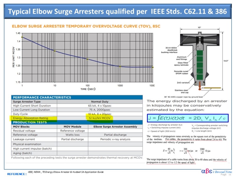

You might need an EMTP study to determine if the joule rating of the arresters might be exceeded during a stroke. The line capacitance may be discharging into the last arrester, which would discharge first because of voltage reflections.

The best way to determine the adequacy of surge arresters is to prepare an accurate system study to value the arrester rating. However, this is not only time-consuming but also could be very expensive if contracted with an experienced organization.
A conservative rough estimate could be determined per the enclosed excerpt below. For the solution of replacing the surge arrester, consult with a serious manufacturer and suggest if a parallel surge arrester may help the suspected exceeded energy capability during a lightning strike in the region of the project.
I hope this help
