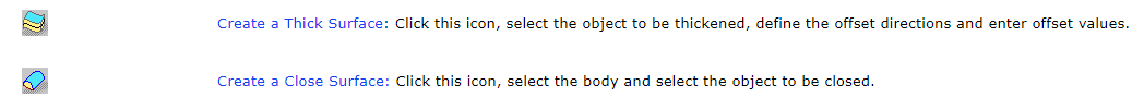

How can I make my surface designed product to solid ?
The two most common tools to make a solid from a surface are the Thick Surface and Close Surface tools in the Part Design workbench.
