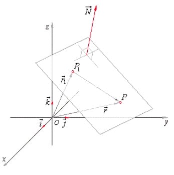

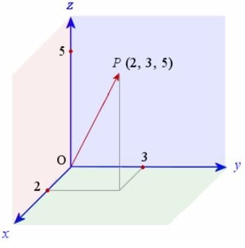

I would absolutely agree with AndrewTT/drawoh - a theoretical point/axis/plane cannot have a datum reference directly applied, datum planes/axes/points are always derived from the actual features on a part. A datum target is also what came to mind.
In regards to the being normal to the DRF theres no requirement that any feature and its FCF is normal to the DRF. In the example you are trying to create here your DRF will be 3 mutually orthogonal planes - where these 3 planes intersect is the origin of your DRF. This origin and three mutually orthogonal planes are where all dimensions need to be connected to and all measurements will be taken from this. If you think about it like the below, what you are doing is just setting up your x/y/z coordinate planes. These dimensions/features can be located anywhere in space as long as their relationship to the DRF (x/y/z coordinate planes) is fully defined. A single out of plane point/line/plane can be thought of like the below in terms of vectors and coordinates where its relationship is fully defined in relation to the 3 mutually orthogonal planes/origin. The same concept can be extrapolated to any other feature like a collection of points for your profile tolerance.

Thanks all for the replies and insight, especially you chez. Thinking about it in terms of the coordinate system and a vector that cares about that cares about the one extra point of travel along the 3rd axis has really helped me understand this a bit better.
