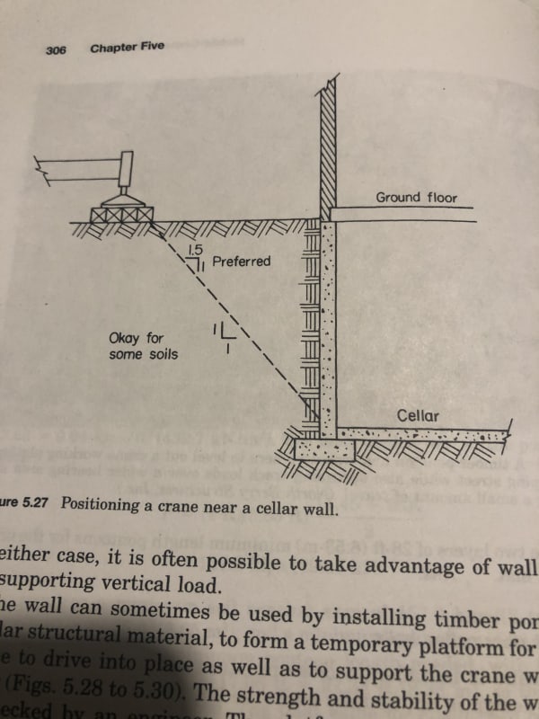

In the book "Cranes and Derricks" by Shapiro, they recommend a 1V:1.5H slope to be outside a "failure wedge" of the soil and note the same 1:1 slope for some soils for surcharge loadings from cranes.
This simple rules of thumb "design guidance" actually makes sense if you look at it from a soil failure wedge perspective.

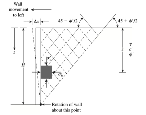

No vertical load should be included in the lateral earth pressure calculation for subject located beyond the theoretical failure plan of the retained soil.
TheRick109, I don't have my copy of Cranes and Derricks with me but can you check on the 1V:1.5H that you typed? To get beyond the theoretical failure plane, the slope would be more like 1.5V:1H, not 1V:1.5H.
I agree, if you are using Rankine theory, the failure wedge for an active loading results in an angle from the horizontal of 45 + Phi/2. That's why the 45-degree rule of thumb "design guidance" (1:1) has been used because it's conservative.
The 1V to 1.5H is even more conservative since that's for the passive case of 45 - phi/2.

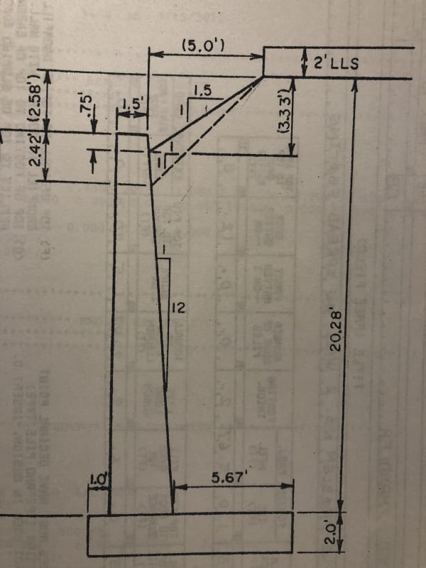

From Cranes and Derricks:
And from the 1972 New York State DOT Wallrun user manual (note in this example the 1:1.5 is the backfill slope) :
