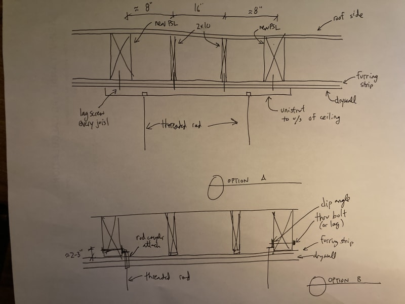

What is the most practical way to hang threaded rod from ceiling joists, taking into consideration drywall and attachment accuracy? See the attached for Option A and Option B
Option A: Install new beam, cover with ceiling finish, then locate joists and lag in a Unistrut to the U/S of ceiling into every joist.
Option B: Install new beam, attach clip angle and thru bolt through the side of the new beam. Put a rod coupler on. Attach threaded rod. Make the drywallers cut and patch around rod locations (or...let them run everything flush and then cut out circular holes for the rod).
Option C: (not shown) Similar to either A or B, but run the Unistrut parallel to the new beam.
The application is a hood exhaust in a restaurant. Threaded rods fit to clips on the hood.
Anybody have some suggestions or opinions? Looking for a semi-foolproof way to have this installed with relative ease. Option A seems like the easiest method, but I'm not sure I like it structurally (lag screws into narrow face of joist). Option B is the best load transfer method, but it requires installation tolerance to be bang-on.
