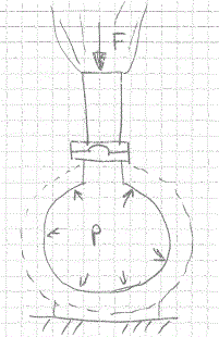

Support rings at burst disk location
KevinNZ
Jun 12, 2003
850
Has anyone seen a need for support rings around a vessel or pipe where a burst/rupture disk is located? Can the thrust force from the disk exceed the internal pressure force and cause the pipe/vessel to collapse?
The reinforcement for the nozzle of a relief device is done when the nozzle is designed. Rarely is it necessary to strengthen the entire vessel cross section.
Review ASME B31.1 Non-Mandatory Appendix II, "Rules for the Design of Safety Valve Installation"
MJCronin
Sr. Process Engineer
Suggest that you consider reposting in "Safety & Relief Valve Engineering" Forum
MJCronin
My answer to your question is "no". To see for yourself why, draw the free body diagram.
