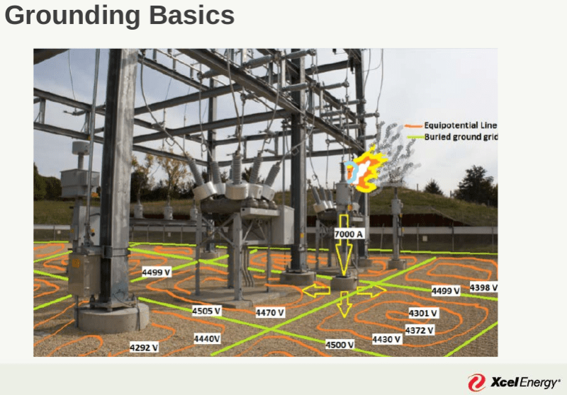

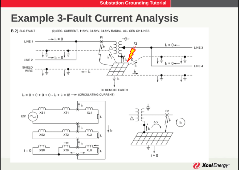

I've never quite gotten my head around the concept of "GPR". Is GPR the voltage difference between equipment in substation and local earth, equipment to remote earth, or difference between local and remote earth.
If someone has a basic example, they can share to help solidify I'm sure that will clear things up for me. Thanks
Substation ground grids serve the same safety purpose as equipotental ground mats, reference thread238-166391. Reviewing the discussion regarding equipotental zones and equipotental safety mats may clarify some of the points being made above.
The linked presentation discusses "IEEE 80-2013 - IEEE Guide for Safety in AC Substation Grounding", and has some examples of remote faults in segmented power systems.
Substation Grounding Tutorial, Joe Gravelle, P.E., Eduardo Ramirez-Bettoni, P.E., Minnesota Power Systems Conference;Thursday, Nov. 9, 2017
