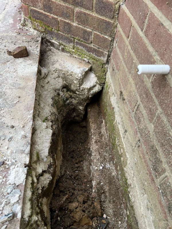

I come from an electrical engineering background so structural engineering is not a strong subject for me. I kindly ask and would appreciate if there is someone that can offer their proffesional advice.
My property has suffered from subsidence, which happened back in the very hot and dry summer of 2022. Cracks have appeared through mortar lines and brick internally and externally, mainly around the front two window bays of the property. It also affects the opening and closing of the front living room door upon the clay soil swelling and shrinking through the seasons. Soil samples have been taken which show high VCP and very high plasticity levels. The vegetation has been mitigated and should no longer cause issues. Monitoring has been setup to see how the ground responds over the next 6 months.

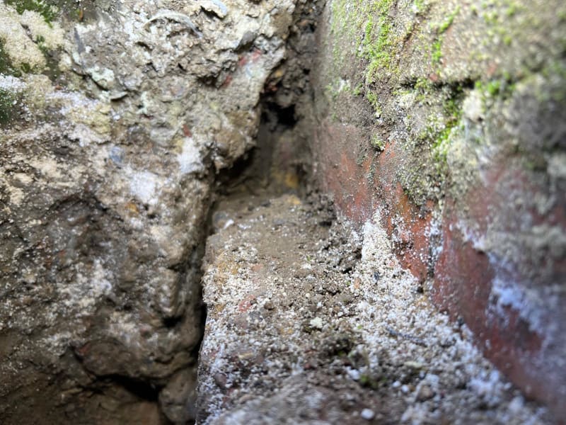

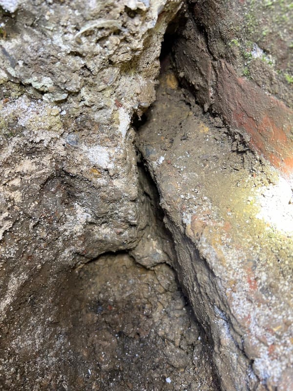

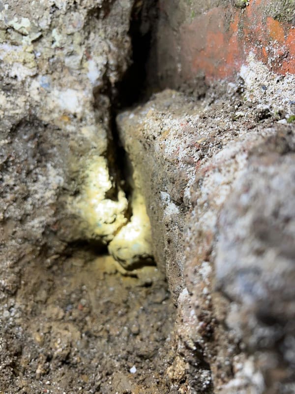

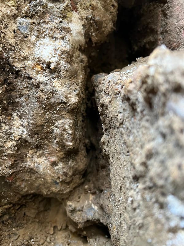

I need help understanding what has / is happening to the front window bay foundations. There is a large crack / seperation that has been uncovered when a trial pit was dug. The property is a 1930's semi-detached chalet so the foundations are not deep and sits at the top of a sloping drive. Is there cause for concern here? Does it require underpinning? Should the part of the foundation supporting the window bays be seperate from the house foundation slab? Or should they be connected together?
I have tried searching the internet for answers but I can not find anything that describes how these foundations should sit.
Thank you in advance for investing your time in reading this.

I think a zoomed out photo would help paint a better picture. Maybe a shot or two of the exterior so we can conceptualize better.
Also, do you think the bay window is original to the home, or an add-on?
Hire a local geotechnical engineer to help and talk to several foundation contractors that specialize in underpinning. You don’t have enough information to share that would give us a slight chance of giving solid advice to fix your problem.

You might be right StrucPathologst. I’m aware it may well be ridiculous to find answers with a brief description and pictures, it is wishful thinking, but I hoped to find someone who might recognize this issue from their own experiences. Insurance companies often seem overly confident in their assessments based on mere photographs, which prompted me to seek additional insights here.
I have taken some additional photos that hopefully make things a bit clearer for those that are interested. The trial pit is dug between the two window bays. The pictures taken are of the right hand side of the left window bay. I appreciate you all taking the time to respond. Thank you.

The window bays look like add ons. Different bricks. Different footings. You sure it was all built at once?
If you have two different footings sitting on different soil, this is going to happen.

@Tomfh The window bays are original and have been part of the property since it was built in the 1930’s. If they are different footings and that is the intended design then does it not bring into question as to how far they should sit apart? Should the window bay footings be resting on the house footings? Or should they not be touching at all?

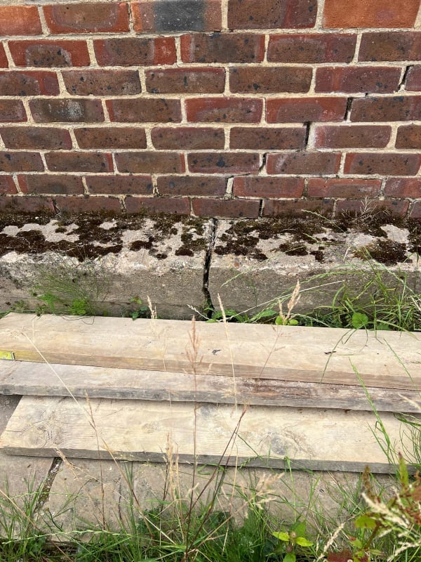

I’ll include a photo of the garden wall, which is also part of the insurance claim. You can clearly see how the foundation has cracked, occurring simultaneously with the subsidence on the property. This raises serious concerns about the stability of the house foundations. Given that the garden wall foundation is now separate, I wouldn't be surprised if the insurers dismiss this by suggesting the foundations were originally poured this way, using it as a justification to limit their liability.

How do you know the bay windows were built together with the rest of the house?
I suspect the plans changed at some point (maybe during original build) and the additional bay windows were tacked on.
In any case, yes they should have been connected together more strongly, and founded upon the same material.
